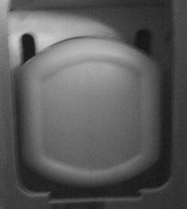

I was fixing the fuel tank into the fuel tank compartment of my new Avistar 40 and was thoroughly disappointed with the poor vibration isolation. First of all no mention of rubber foam padding was made in the manual. Second, the tank is push fitted into a plywood holder, which simply means that the engine vibration is directly transmitted to the tank !
Is there any Avistar flyers that have mounted their tank without any modification and found no problem with fuel foaming ? Would like to hear experiences out there and what modifications done..........
I plan to sand out the plywood holder so that I can squeeze in some foam in between the tank and holder. Also adding foam all around tank, including the front part which touches the firewall.

Default just took a shot of tank
I just took a shot of the tank. Can you see the plywood "holder" in contact with the top of the tank ? The holder at the bottom cannot be seen in this shot. Do you guys have the same type of design ? I can't even wrap the foam rubber BEFORE I fit the tank because the plywood holders are obstructing. So I will have to creatively fit the foam inside the fuel compartment first and somehow push the tank through the plywood holders and putting a finger through the firewall hole to manipulate the foam to fit around the tank !!! ................

Yes this is a great flyer! Where is the pick of the tank and fire wall. If i was you i would just lay some foam in the fuselage in the shape of a U and then push tank down and then cut a piece of foam to cover the top and screw the hatch down. No problem!

ok guys. sorry about that. here's the photo. the top plywood holder can be seen in direct contact with the top rear end of the tank. there no hatch in my avistar btw. that must be a much earlier version I suppose...................

Just stick foam in the opening and push the tank through you will be fine.The foam will isolate vibes enough to were there is no foaming even if the tank touches the supports.
