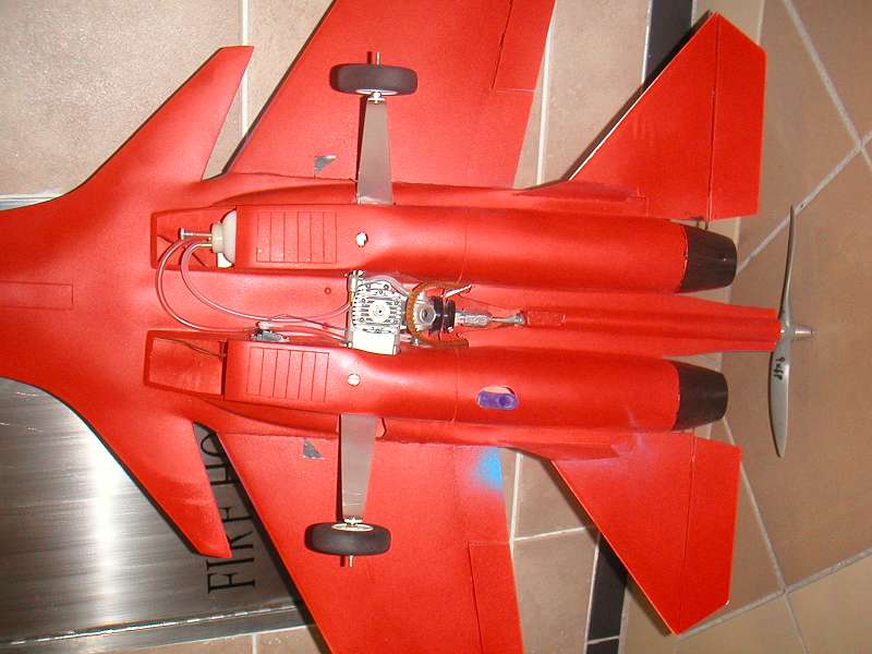

forestroke's Avatar
Joined: Oct 2003
Posts: 1,942
From: Taipei, TAIWAN
Default First flight of experimental propjet tomorrow!!!
I have finished my experimental propjet. It is a AMD SU-35 Superflanker glider converted to a nitro power plane. The engine is mounted upside down between the two "jets" with a speedometer cable drive train from boats. The muffler is in one jet while the fuel tank is in the other. The pusher prop is mounted way back where the tail naturally ends in a cone. It will be belt started and powered by a O.S.32SX. The only problem I see so far is the added weight and more importantly the ground clearance of the pusher prop. It allows for only very shallow take offs and landings. I am deathly afraid that the prop will hit the ground and stall the engine upon takeoff. Wish me luck! Will post pictures afterward... hope they aren't of me weeping!!!

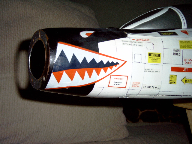

CARS II's Avatar
My Feedback: (7)
Posts: 6,658
Received 137 Likes on 120 Posts
From: Sacramento CA
Default RE: Idea for a prop jet
You mean something like this.
CARS II

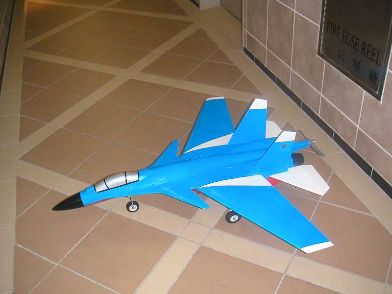

Old 05-24-2004 | 03:02 AM
forestroke's Avatar
Joined: Oct 2003
Posts: 1,942
My prop jet hasn't taken off yet :-( and I don't have any time left. I'm considering selling the project to a friend since I will be moving soon and this plane will not survive the move, I suspect. Anyway, getting the engine started using a flywheel from a boat was more difficult than anticipated. And when I tried to start it from the prop end, the shaft snapped (as expected ... back to the drawing board when I get moved!
Old 01-10-2005 | 02:00 AM
forestroke's Avatar
Joined: Oct 2003
Posts: 1,942
This plane finally did take off but I did also have to sell after the first day of flying. Like my WM Ultimate 30... The best offers come right after you have a decent flight. This one had a taker even before the maiden! After dremelling away more of the plane to make room for the belt to eject after the engine started, I finally got her airborn... these are pics a few days before...
