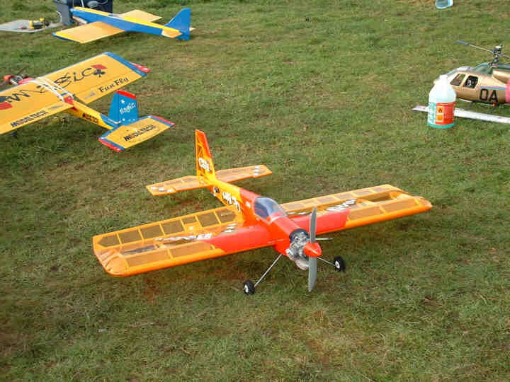

I just got this model and in the middle of getting her together,it is just a dream to build..should be done in about 4 hours!
Im putting an LA 46 in and Futaba radio gear.
This seems like one of the real good deals in an arf these days.
I will report back in from a test flight.
I wish all arfs would come "almost ready to fly" as this one did.

I think you will find that you need a much heavier engine, else you will need to add a load of dead weight to the nose. I have the Irvine Wild Card which is the same model, and had a 46la on it, and it was MILES out on the CG. I ended up putting an OS 46AX on mine to save adding extra weight.

I took that junk LA 46 out and put a NEW Magnum XLS .46 and WOW what a difference!
Makes this plane even more fun to fly....
LA could not hold a throttle setting and deadsticked on me all the time..the Magnum is a fine running engine,gave this plane some class.
