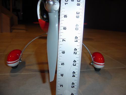

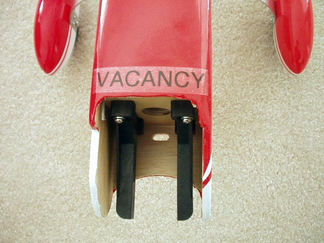

Obviously, the gear height of the SE can be/is an issue with 4-strokes. Can you get by with a 3-bladed prop to bypass changing out the gear?

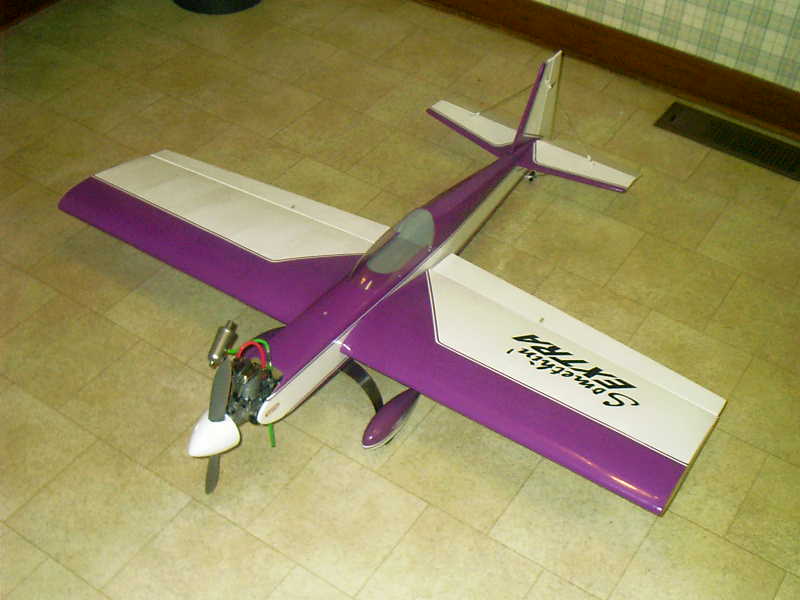

i have a saito .72 in my something extra and its by far my favorite airplane to fly. Its a great combination and it easily pulls it out of a hover and straight up forever. you dont need anything bigger than the .72.

Hey SearchMan--that looks like the stock main gear on your SE ARF. What prop are you using on that Saito .72?

I am just finishing up the covering on my SE kit. I and others that I know fly it have (in some cases) replaced the gear with one that sits a little higher. That's what I have done on mine. BTW: I will be using the OS46FX for my powerplant.

Ordered the aluminum landing gear from TnT Landing Gear Products (www.tntlandinggear.com), part number LG-177.

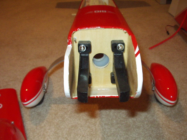

hey search man could you please get me a close pic of your battery as this i about where i need to put mine.i was thinking about covering it after i put the batt in but it looks like you have yours open what keeps batt in details please

My close up of the battery installation doesn't show too much - I cut the covering, glued in some popsicle sticks, stuck the battery in and held it in place with foam. I haven't re-covered yet because I keep moving the battery back further (it is just about as far as I can go now). I did this same thing with my first SE and it would Knife Edge all day without increasing the rudder size like some have done. This plane rocks! I'll post some pictures of the mods I made. The TNT landing gear gives me 3.25" clearance with the stock wheels.

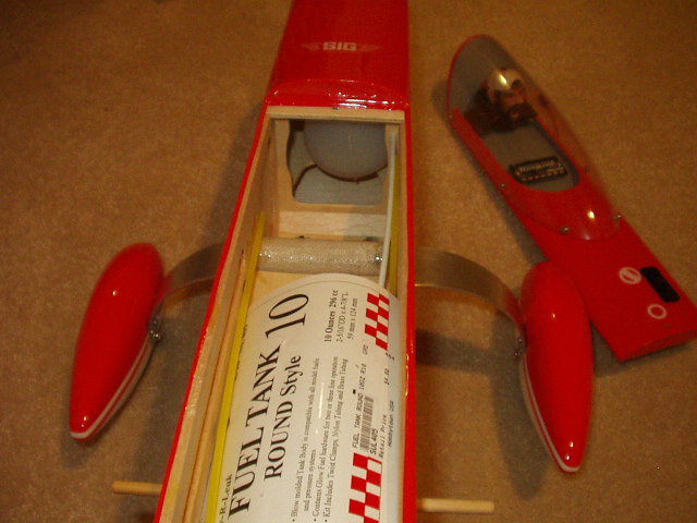

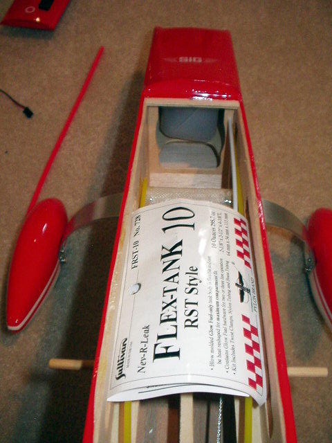

I test fit the Sullivan 10 oz. round tank in the SE. Got it past the wing tube okay. Looks like I would have to hack on the fuel tank shelf to lower the fuel tank a little bit.
My 10 oz. tank doesn't stick out nearly as far as your tank installation does. Is that the 12 0z. Sullivan tank?

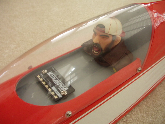

I know these pilots add weight; however, this one just seemed like he needed "a lift."

Mile - Hi:
My tank is a 10 oz. The reason my tank is located where it is, is that I was trying to move the CG back as far as possible. I have about an inch or so of foam in front of the tank. I did have to use a dremel on the tank shelf to get the thing to fit properly. I also taped some nylon string to the front of the tank so I could easily remove it if needed.
I cut the cockpit shelf out and the head rest to save every ounce I could. I really like your pilot!
Here in Illinois, I am about 800' above sea level and my 72 has no problem going vertical for as long as I want - I don't know how your altitude will effect your vertical capabilities. I'll be anxious to hear how your SE performs.

FWIW, I just test fit the Sullivan 10 oz. Flex-Tank, part number S728, in the SE. Only required minimal heating to the tank to get it to squat, slightly, so that the tank would fit through the firewall without modifying the tank shelf.
Just kept reinflating the tank during heating so that it kept about 98% of its original shape; i.e., no cavities.
There is actually room for the 12 oz. Sullivan Flex-Tank, part number S729. Anyone know if that would be necessary if using a 4-stroke; e.g., FA-72, to get approximately fifteen minute flights? Yes, I would be off of full throttle for at least the approach and landing phase...Or, would the extra two oz. of departure fuel just add insult to injury concerning CG issues?

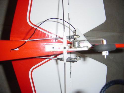

search man,one more ? please.when you put your battery in the rear could you get the wire too the front all the way.what i mean is i have an arf and i dont know if there is a bulkhead in the way or will the cable just feed itself through to the fron without having to drill a hole for it.also i like where you put the onoff switch it is where im putting mine.

Bullet65,
If I remember right, I had to just fish the wire through/under the bulkheads. I might have had to make a hole, but it was nothing difficult or I would remember it. Your 91 looks great! Let me know how she handles.
