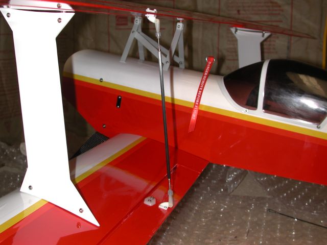

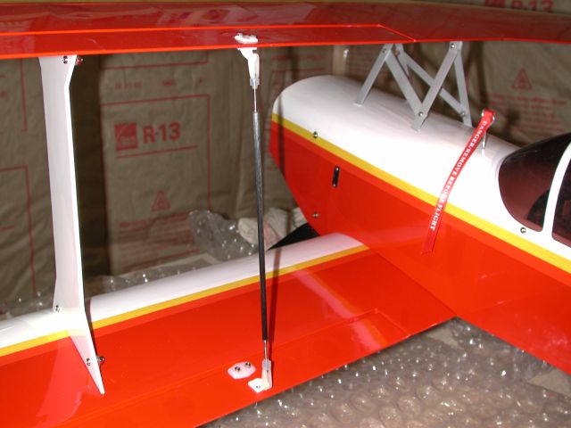

I have attached a picture of my carbon fiber pushrod setup on the wing.
I was wondering if the top wing was going to line up correctly also.
I did the following. Placed the screws in place on the center cabane. I then installed the interplane struts. Everthing then lined up. I had to had to monkey with the interplane fittings to make sure the wingtips were equal distance apart.
I had to look several times at the picture to make sure which way the interplane struts were positioned. The are positioned on the outside of the lugs.
I hope you get everthing straightened out. No pun intended.
