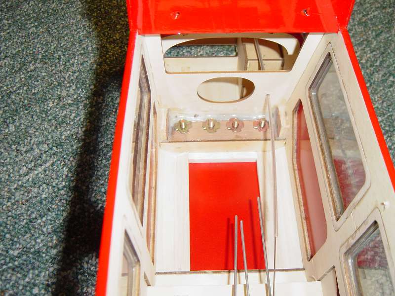

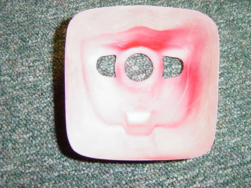

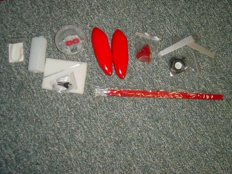

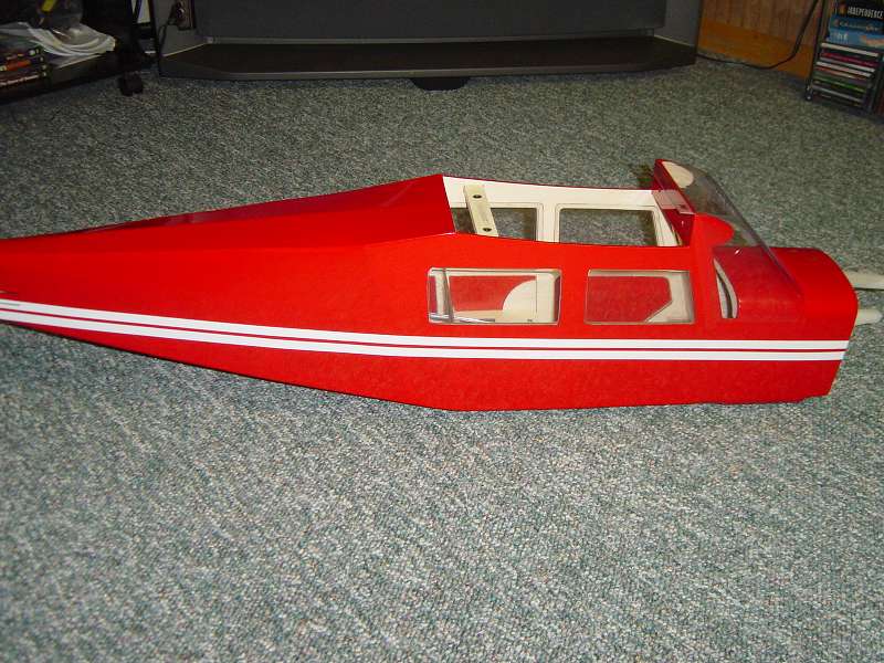

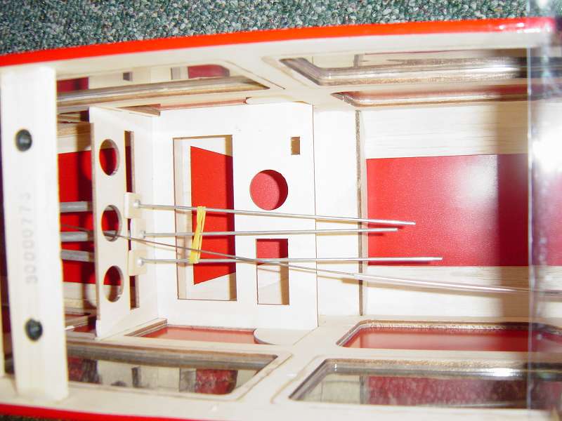

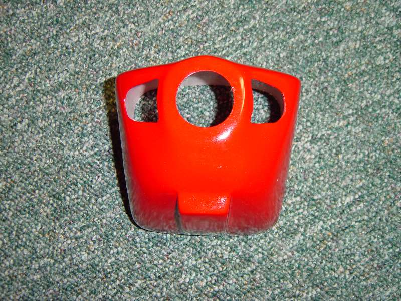

Well here are some pics for everyone. The cowl and wheel pants are fiberglass. The fuel tank stopper has the lines already installed. It comes with a spinner and the struts are very sturdy. The only thing I did to the airplane was to CA the hinges. The engine mount was already installed as were the control pushrods!

Here are more.

And a few more! The aileron servo covers are already installed!

vxoa203 im assuming from the pics it requires 2 servos for seperate aileron installation?
Old 06-01-2004 | 08:51 PM
My Feedback: (20)
Posts: 149
From: Kings Mountain, NC NY
Default RE: Seagull Decathlon!!
Yes, 2 Aileron, 2 elevator, 1 rudder and 1 throttle servo for a total of 6 servos.

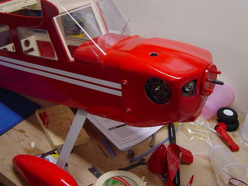

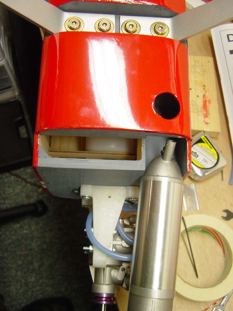

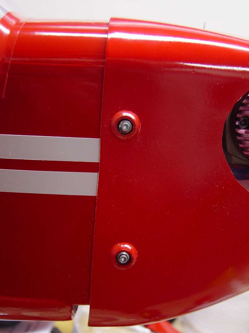

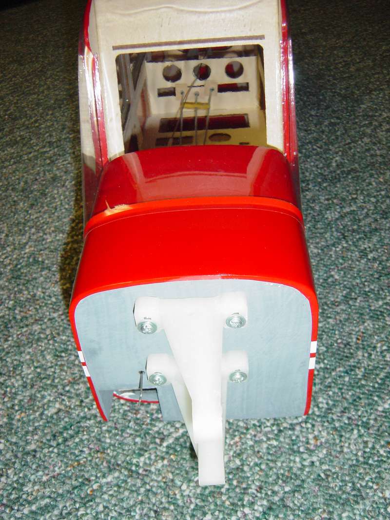

Well, construction continues-

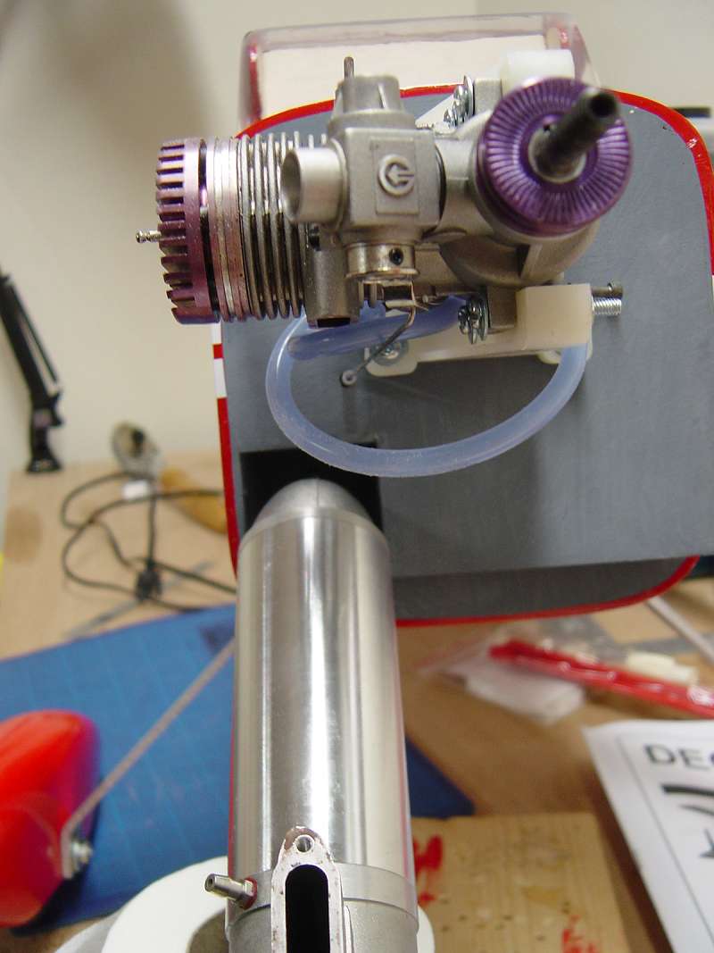

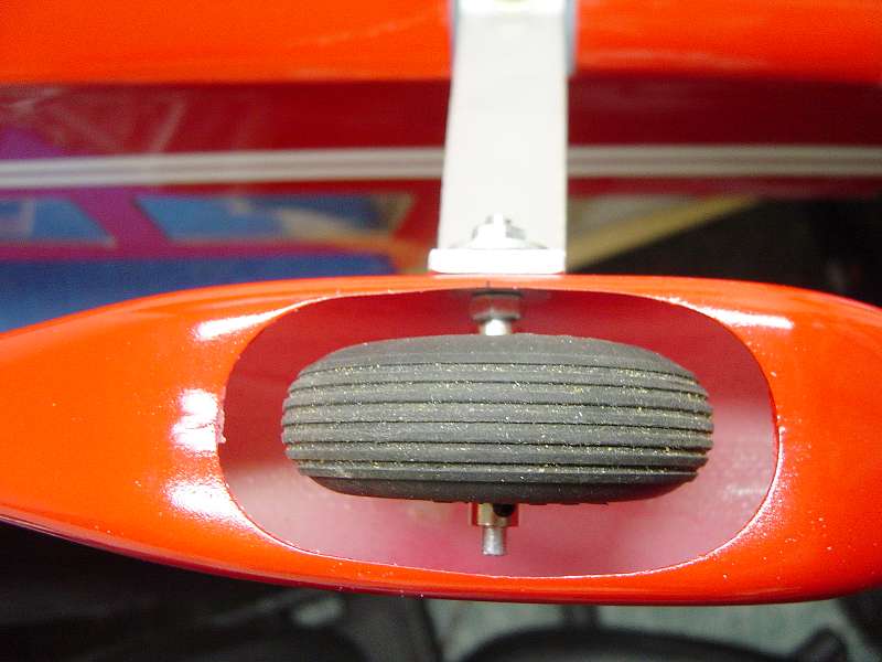

The wheels were very low quality foam, so they went into the trash. I mounted my Tower 46 and found that the muffler is too big to fit without major surgery on the front of the fuselage. I am getting ahold of a pitts style muffler tomorrow. It will make for a cleaner look without chopping the front of the fuse up.
The instructions called for screws to attach the fiberglass cowl. I didn't want to attach the cowl with just screws so I am used PSPMFG cowl binders to attach the fiberglass cowl. They come white and they can be painted any color you like. I have them on my GP Wagstaff and they work great.
I have the landing gear completed also. There is no provision for anti- rotation screws for the wheel pants. They are just put together with washers and nuts etc. We shall see how the stock wheel pants hold up at the field.

Tower 46 muffler pics-

good looking pics, the plane loks really sharp!
where did you get the cowl binders? I am interested in getting some for myself.
