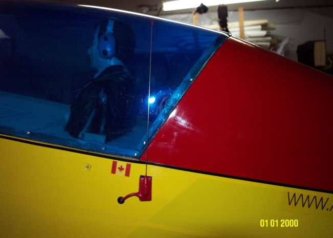

Well, I tried a dye once, not Ritz, and the only thing that got dyed was my hands.
Sooooo, I went and bought Testors Transparent paint.
You simply lightly spray paint the inside of the canopy. You can get Blue, Red, Green and maybe other colors which I don't know.
Here is what mine looked like:

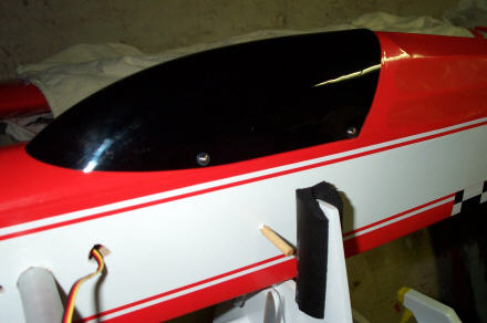

Well, I finally got my canopy tinted on my Somethin Extra. Tried the Testors first.......Run City!........Then got the Pactra, works great. Thanks, JT
