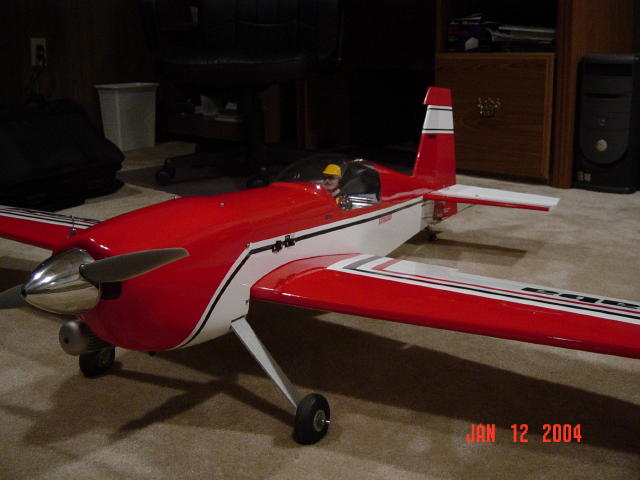

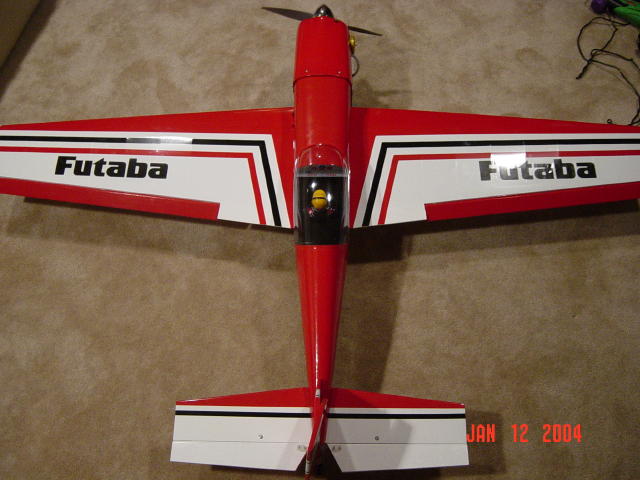

Luke, I can't remember any problems when I assembled mine.....everything seemed to go together nicely.....I did change the tank, though, too small and cheap quality. I also changed the other usual stuff, hardware, wheels, etc.
Mine has unlimited vertical with a GMS .76 A .61 should fly it very well...but might not deliver unlimited vertical. It's not a very heavy plane.
I did something a little different with the scheme on mine....I didn't like the blue decals with the black wing striping, so I added my own decals and used black striping tape on the fuselage also.
