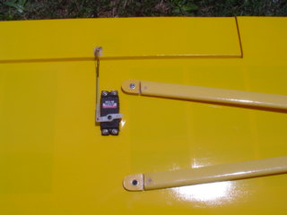

I've been having problems with those weak CA hinges on the GP Cub J-3 ARF. While I'll repair them again, I was wondering if those struts are just for show, or are a really necessary part of the structure. It doesn't seem like it to me, but I wanted to check with you all just in case.
Could I get by with not using them? I don't want to have to worry about babying the plane without them, but sometimes the strut fails and ends my day early.

Yes the struts are critical. mine did the same thing as yours broke after just a few flights. the fix I did was to take some coke bottle plastic and cut it to fit all the way into the wood of the strut and the wood that the bolts go thought to hold them to the plane. used some epoxy and drilled some holes for some wood pins and redrilled the holes for the bolts and have not looked back since. if I have a pic I will post it but if I do not I will post one in a few days. I am going out town later today

OK here is one pic that I have look at the strut on the left at the time that I took the pic I had not fixed the others I wanted to see how the fix worked first before I did all of them. they all are done this way now and work great

Here is one pic that I have

Hay Dude, The instructions say that the struts are functional. I also did the coke bottle fix and it works great. However my Cub is usually used for introductory flights so I also glassed the wing center section. I cut the covering off two inches from the center of each wing. Then put six layers of ¾ oz. glass 3in wide over the center section and recovered with replacement fabric purchased from Tower.
Being used as a introductory flight plane I can say unequivocally that the glass eliminates the need for the struts. But it requires more time and money (just like any ARF).

Well, I went the epoxy/Coke bottle (actually Dr. Pepper) route and replaced two hinge points on the left wing. I pinned them too, just like RamDuster did. Seems to be pretty solid.
Flew it once, then noticed the right bottom hinge popped. I'll just replace them all with the plastic from the soda bottle.
Even if the plane didn't need the struts, it just wouldn't look right without them. I dream of the day when I can take this plane out for four or five flights and bring it home not needing any repairs on it.
