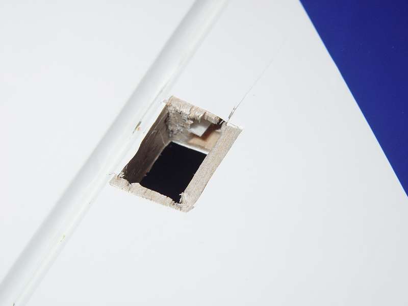

Big news is that the glue joints on the left aileron servo mount in the wing failed. Fortunately, this was caught during a preflight; the servo, mounts and all, was flopping around in there. I had reinforced the actual mounting pads (where the servo attaches) with quarter-inch square spruce, for the screws to bite into, but I didn't do anything with the mounts where they attach to the wing structure. I'll have to spend some time fixing that.

Aside from the (barely visible) cracks in the fiberglass, the servo mount coming loose (in the process of repairing that as this is written) and the odd spot here and there where the covering is coming up, there has been no "wear and tear". I can photograph any specific part of the model that you might be interested in; but ask quick, because the wife is going to Dallas tomorrow for a week and she's taking the digital camera with her...

De-covering is probably a REAL good idea, in light of what just happened. I'm wondering now what other glue joints are getting ready to fail. While I will take the time to repair minor problems on this airplane, I will not spend another dime or any major effort on it, and intend to fly it until something claims it, or I get tired of it.

Be warned that the alieron horns are screwed into the soft LE wood. Both of mine pulled loose and almost fluttered the plane to death at 35 flights. The wood is so chewed up now that I'm going to have to cut the entire section out and inset a piece of hardwood. If you catch it before the wood fails, you can inlay 1/64 ply scabs on both sides for the horn and screw plate to bear against.
