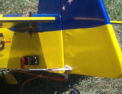

Modifications: If you already have a snappy Kyosho CAP and are wondering why on earth this guy has such a rearward CG and does not have problems… read on. Basically, the flight reports here in RCU indicated a plane with really sensitive elevator. So what can one do about it? Basically, throw away the stock pushrod and install an elevator pull-pull to avoid flutter and elevator differential on the travel extremes, seal the gaps, adjust the up-down travel volumes really carefully, and the snap is gone. I am aware of some people asking about split elevator pull-pull setups, so here are some pics of my set-up. First, you must install the elevator servo on its side relative to the fuz floor and the horn must be bang-on the fuz centreline. The high stab of the CAP design favours the placement of the servo in the cockpit floor of the model. You only need to make a new servo mount. Make sure it is strong and screw it down as well as glue it, though, so that is does not get pulled out. Use a dual BB servo to take the strain of 4 taut lines to the elevator halves. The only difficult thing about this installation is the careful marking of the wire exit holes so that they have a minimum diameter and also to ensure that the wire runs completely straight from servo to control surface. In order to do that, you need to rip the covering of the bottom aft fuz away to pass the wires through the formers. However, that is a great opportunity to lighten the back end of this typically tail-heavy model! If you look at the pics carefully you will see some lightening holes on the ply formers. In fact, I lightened the aft section enough by the deletion of the pushrods to be able to move the rudder servo right in the back and use a short straight pushrod. This allowed the ply servo mount inside the plane to be removed completely saving even more weight. The end result of low overall weight (5.55lbs) with a 4-stroke engine also helps minimise the snapping tendency of the plane by reducing the stall speed.
Problems: Yes we can all do without those but in this case I was hit by some radio interference on the first flights. The faults were basically the use of a single conversion Rx coupled to some metal-to metal noise stemming from the pull-pull system. Since two wires go back to the elevator halves, per actuation side, I initially drilled out some stock threaded rod to take both of them from the servo side (via a clevis) to the surfaces. The drilling-out produced a shard-edged hole that cut into the wires and created some RF noise. Now, there is a good reason for the price difference between single and dual conversion Rxs. Basically the quality of the materials inside, apart from the second RF conversion, is very low. So they get easily affected by metal-to-metal contact noise such as that from metal-geared servos or rubbing pull-pull wires. I discarded the clevises of the elevator pull-pull on the servo side and simply run the wires through the servo horn holes. By changing to a dual conversion Rx all glitches were gone for good. I also used counter-locknuts to ensure that the wire ends near the surfaces would not vibrate/rotate inside the clevises.
