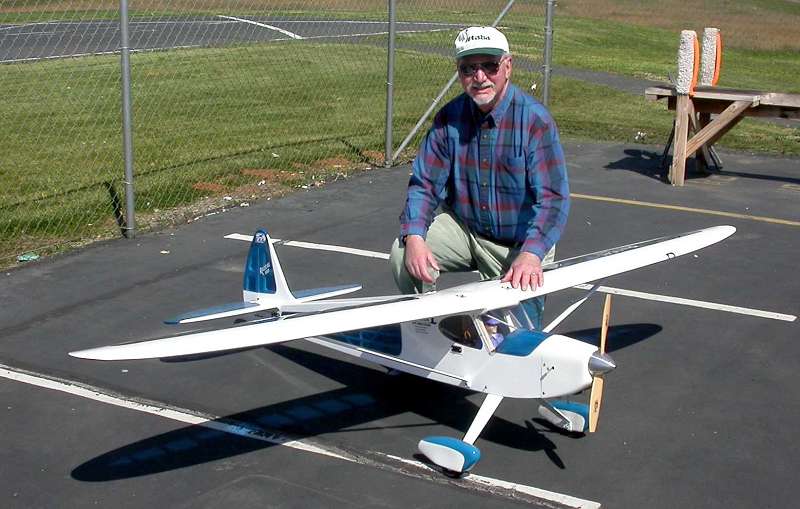

Default RE: Rascal 110 sheds wing!
In an Email exchange with Scott Christensen it has been concluded that the bolt failure was an unusual and isolated incident and in no way reflects against the design or construction of the 110. Even so, Sig was kind enough to offer me a sizeable discount on a new factory fresh one.
It is a great aircraft and I look forward to getting one back in the air! ( with some minor bolt mods, of course!)
