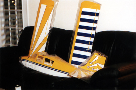

I bought mine from "Fun Time Hobbies" in Stone Mountain, and I'm glad that I did, because someone else was going to buy it!
Yea! I beet him to it, whew!
This is a beautiful plane, and is the reason I got into this hobby, was so that I could get one of these... or a Dynaflight, but those don't come as ARFs.
I did want to install "RAM" NAV lights on it, but the wing tips are "edged" and are not to real "scale" appearence, but either way, it's beautiful.
It's my winter project and haven't yet started building it, but here are some photos.

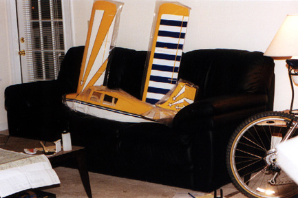

Look at the size of this thing! It's huge, not "giant", but huge...
It's sitting on my main sofa!

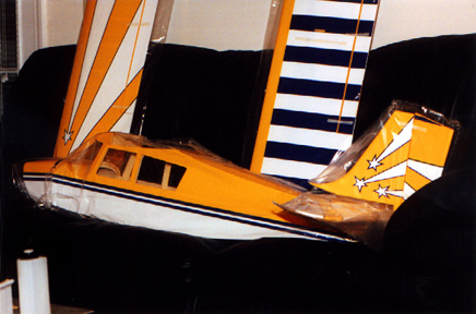

The Dynaflight has an 89" wing span, and it takes a 1.2 to 1.8, and this Goldberg with it's 80.75" wing span, asks for only a .70 to .91, is there any harm in increasing the engine size to 1.2 or higher?
