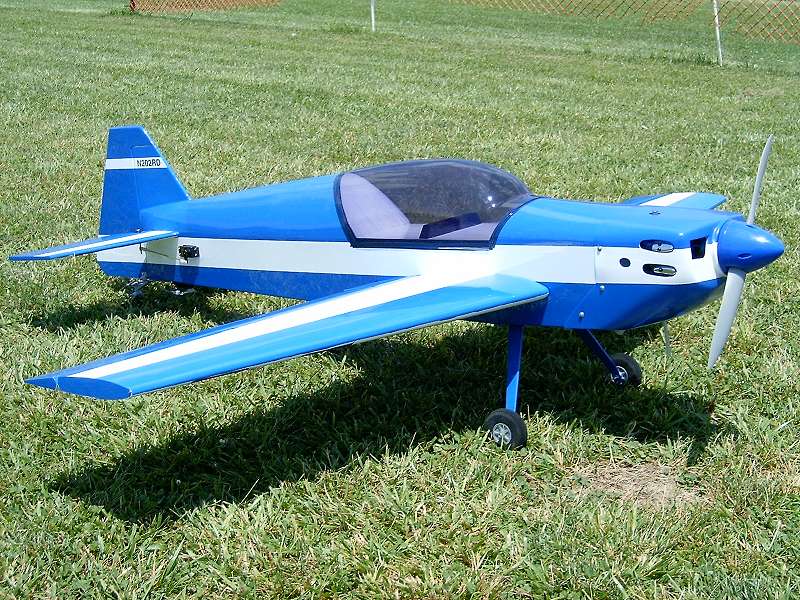

Hey Luke,
Nice looking Giles.
I just finished one a couple weeks ago. I love the way the Giles flies. It is not as lite feeling as the Cap, but flies so straight.
Just dont slow it down too much on Final but still no worse than any other I have flown. If you have not noticed already there is very little coupling with rudder. To me that makes it a great plane to learn precision and good stuff like rolling circles.
Have fun- you will really like it as you get more acustommed to it.
Here is mine.
Nice looking Giles.
Here is mine.
