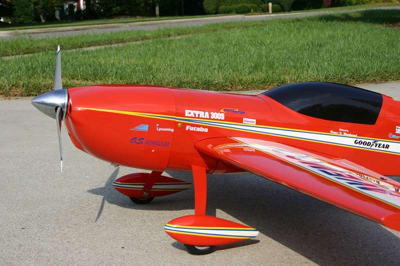

Well, success with canopy glue as you guys recommended. I roughed up the covering with a little sand paper and then *****ed holes in it along the glue line and then added Formula 560. Tied rubber bands all around the canopy and let sit over night. So far so good. It seems good and secured with a nice clean finish. Thanks for your help and suggestions.
To keep the humidity out, and to keep the pressure equal inside I simply drill a small hole in the top of the canopy toward the very back and centered.

rfw1953: That canopy looks very dark. Try to keep it out of the sun whenever possible or it might build up enough heat on the inside to melt it...I've seen it happen before. You probably already know this, but I just wanted to warn you in case you didn't.

TT2 - Nope, wasn't aware of any melting issues. Thanks for the information. This is the first time I have smoked one. Used Tamiya Smoke PS-31 polycarbonate spray paint on the inside of the canopy. I wanted it totally stealth and it worked.

rfw1953: I've seen guys with dark canopies throw a white towel over them when they're not flying. Seems to work OK.
