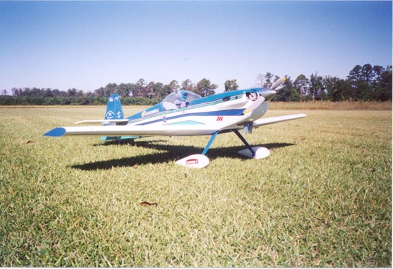

I have a MVVS 150. glow with a b&b pitts muffler on my 1/4 cap.
Setting up second 1/4 cap with Taurus 2.6 gas.
