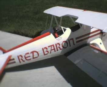

Old 08-05-2004 | 09:49 PM
Posts: 196
From: ypsilanti, MI
Default RE: GP Super Stearman Advisory. (Complete.)
Now with all the minor inconveniences resolved, she's ready to fly!

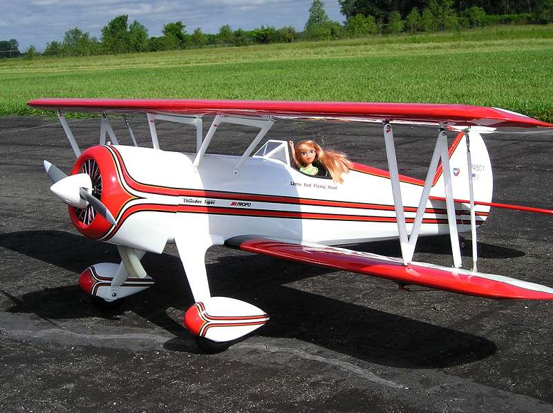

Old 08-08-2004 | 07:31 PM
My Feedback: (89)
Posts: 529
From: Las Vegas, NV
Thanks for the info...I installed the aileron control horns as per RC Report..no binding.
I was going to install an on board ignition system..however the model balanced out without it, so
I think I may leave it off. The plane weighs 14 lbs, hope to test fly it on Wed.
