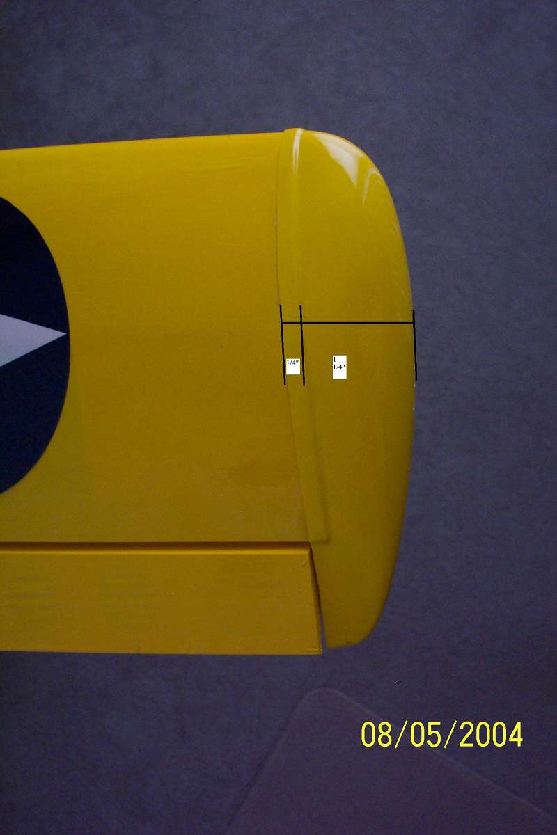

I tried this question in the Warbirds forum with no luck so I thought I would try it here.
I bought a GP Texan ARF kit with some slight easily fixable damage to a wing spar at a good price. It also did not have the wingtips in the kit. GP doesn't sell the tips by themselves. Any idea where to get the dimensions so I can make new ones from balsa or a way to get a new pair of the plastic orginals? I can just eyeball it but I'd prefer to try to get closer. I don't know anyone that has one. Thanks for any help.

Thanks for the offer to help. I guess all I need is the profile of the wingtip. A tracing or digital pic from above would be great.

The only picture I can find is in the manual and the tips are very small in it. I didn't know Tower had a Scratch and Dent! They do have a wing for sale but it is missing both the center section AND THE TIPS. Making balsa tips is the way to go since they would actually be more durable and a lot cheaper. I am going to just trace the wing end shape and start from there eyeballing the picture of the outer shape if I can't get any more info.

I can get you a close up picture and measurement if you dont have it already.

If you have a digital pic please post here or PM me with it along with the measurements. If it isn't digital PM me and I'll give you my postal address and cover the cost. Thanks! The people on RCU are great!

One of the right and left. both are the same size of course. The piece measures a total of 1 1/2" inches at the thickest point, but the wing goes into the wingtip aprox. 1/4". Which means you would need only 1 1/4" on the end. Hope this helps.

I didn't realize with the plastic tips that they wrapped around the wing a bit. I guess this makes sense since they are hollow. Your pics and info are great. Thank you!!!

I took your pics and used Photoshop to make a right and left template last night. They turned out great. Thanks again.
