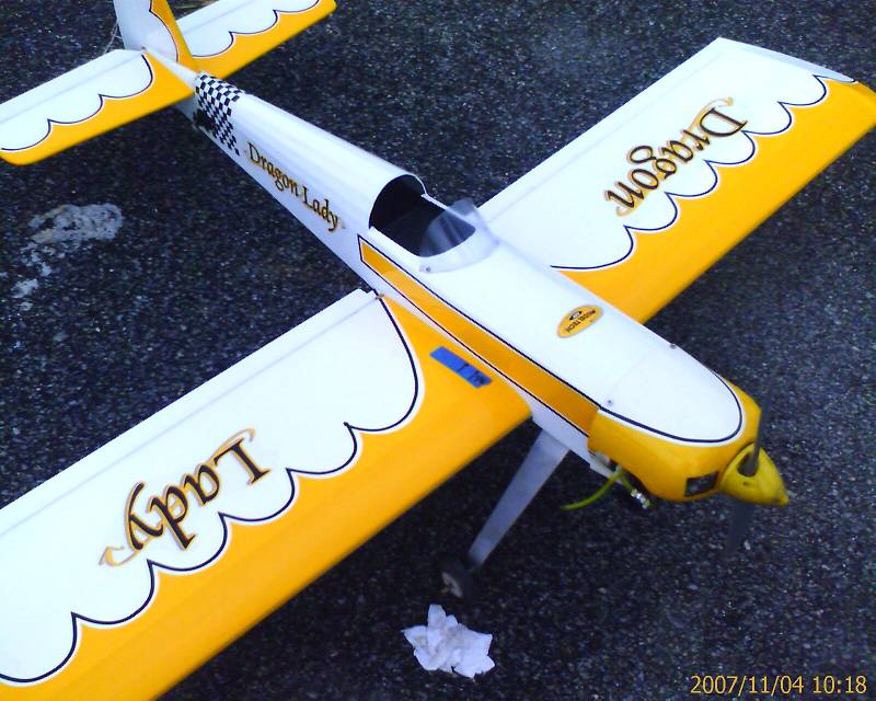

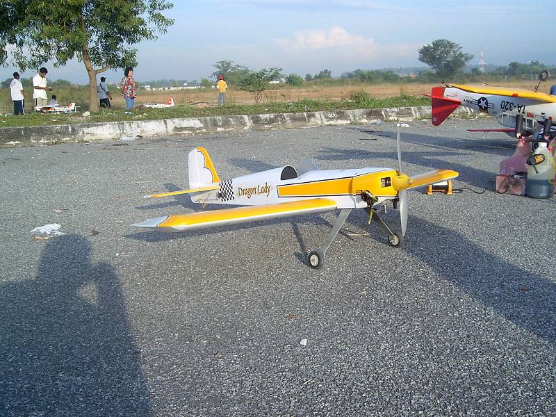

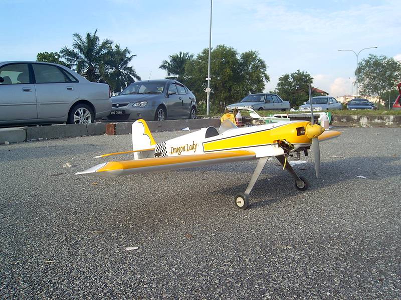

Old 11-12-2007 | 10:10 PM
  #30
Joined: Mar 2007
Posts: 26
From: SERI KEMBANGANSelangor, MALAYSIA
Default RE: Dragon lady

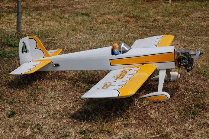

Hircflyer,
My Dragon Lady is fitted with Zenoah 20EI with 4 cell Sanyo 2700 Mah Battery. It allow me to fly 20 min for 3 times.

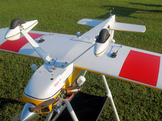

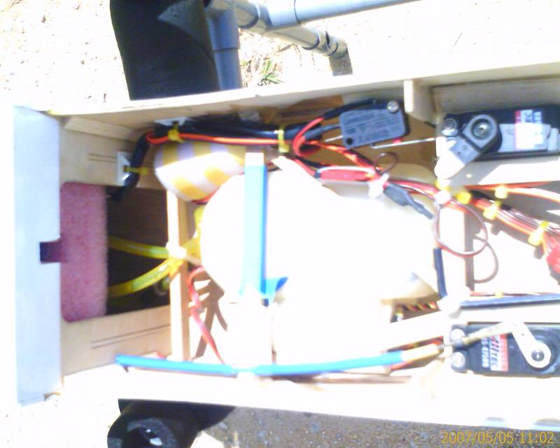

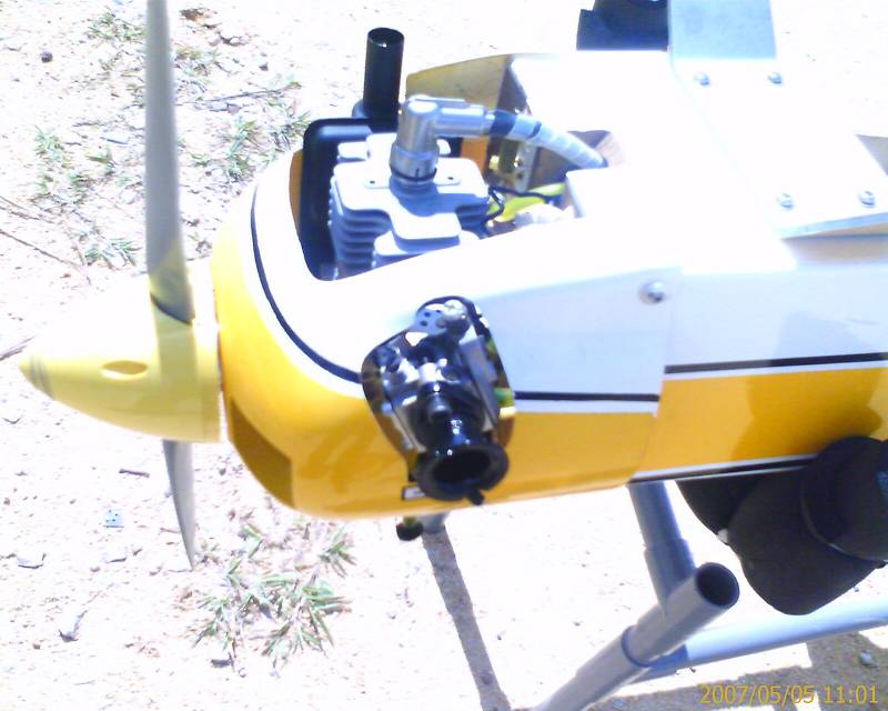

I put the G 23 in mine and it flies great!!!

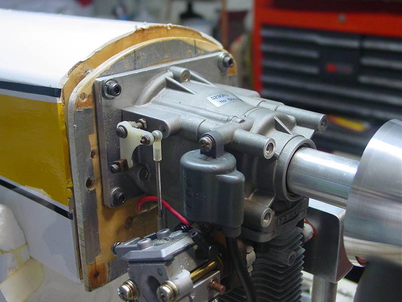

Hey Bill,
I have mine mounted on its side and used the extra plywood spacer that came with the kit to mount to the firewall so that it would push the balance point out further, because the magnum 91 two stroke is considered to be on the lighter side for this plane. I'm still in the process of building this ARF kit and can't wait to get it up in the air...Good Luck and Happy Holidays!!!
Enjoy,
David

ORIGINAL: Hircflyer
How did yours balance with the G23 and the stock metal plate mount? Did you mount the servos in the rear to compensate, or put the main Rx battery behind the wing? TIA
Ed Cregger
Old 12-17-2007 | 03:36 AM
  #39
Hircflyer's Avatar
Posts: 956
Received 3 Likes on 2 Posts
From: Kailua, HI
Mounted servo's in the rear. battery as far back as possible and cut a hatch under the tail wheel and put 1.5 oz of lead. Balanced fine flys very well
Lands almost by itself .....likes our constent trade winds also.
best aircraft Ive ever had.

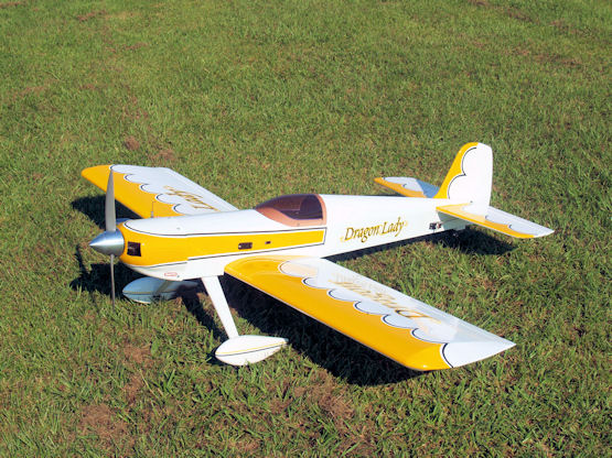

My Dragon Lady is powered by a Saito 120 which seems to be a perfect fit for this plane - it is mounted on a GP adjustable engine mount. I also moved the aileron servo(s) out to each wing and got rid of the torque rod, replaced the wind screen with a canopy from a GP Super Sky Bolt, replaced the wheel pants with ones from a GP RV-4 arf and moved the rudder and elevator servos all the way aft. I also replaced the tailwheel with one used on a GP RV-4. This is an exceptional plane that flies honestly and is very similar in performance to the Super Sportster. It does not look like all of the other present day planes that all look just like each other with different colors - the Dragon Lady has classic looks.

You did an outstanding job assembling and modding your Dragon Lady, Howard. Thanks for the pics.
I'm holding on to my two ARFs until the very end, so to speak. They are great flying models that are super versatile for the sport flyer.
As you have said, a 1.20 four-stroke glow engine is a great choice, as are engines from .61 to 1.50. Each is capable of flying the model well. This model begs for bashing, even though it is just fine as is.
