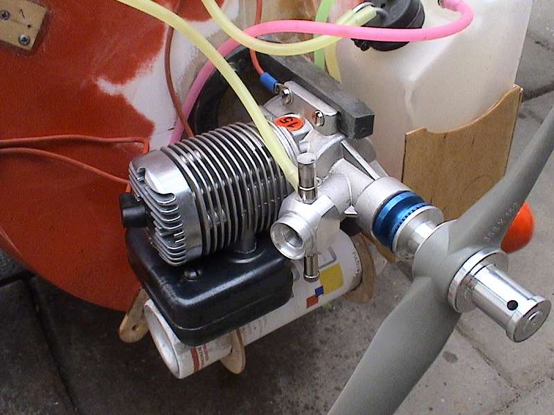

Quick question:
If I mount a Saito .72 inverted in a Sig Kadet ARF ( The BIG one ), the carb. will be +/- 1 inch below tank centerline.. Will this be a problem?? (other than siphoning)?? I plan to use onboard glow driver.
Thanks!!
Allen
Old 08-14-2004 | 04:34 PM
Posts: 7,816
Received 10 Likes on 10 Posts
From: Upplands Vasby, SWEDEN
Default RE: engine placement
Hi!
It will be a problem!
Why not mount the engine on its side?
This is the metod I prefere....
See picture of my GP GEE BEE R-2 below.
Regards!
Jan K
Sweden
