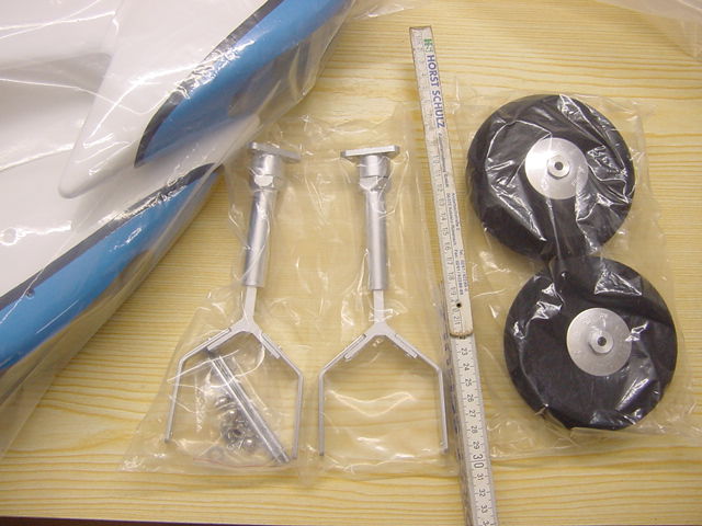

Hello Speed PaNZER. I am curious who made your kit? Is it the Pacific Aero Models kit? You also mentioned spring/tube landing gear. Where did you get this from? I wonder if it is available to us in the US?

Hello Ken,
yes it is Pacific Aeromodel kit. As I live in germany, I bought this kit here from a local dealer, who reports to be selling a lot of those kits. He announced around late summer 2004, that there will be new kit version with that little larger wingspan (2.150mm) and the spring/tube landing gear. I decided for that. Often this kit version I fly is referred to be the "gas engine" version.
Meanwhile, another even larger wingspan kit (2.490mm) is available, the guys claim it does again fly better.
Attached a picture of the landing gear.
Regards
Speed Panzer

Speed , that is interesting to know. No kits other than the original have been anounced in the US that I know of. I think I will check their website though. The landing gear was the downfall if the original kit. I had a custom set of oleo struts made by Robart though. It helped a lot.
