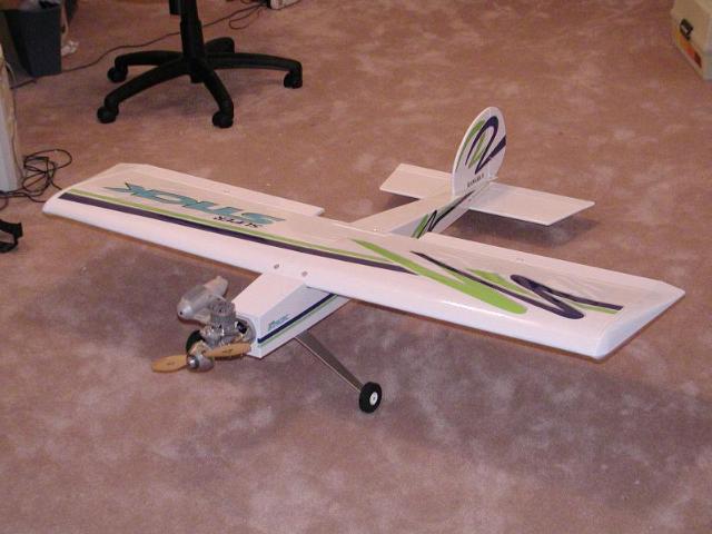

I had a Lucky Stik years ago...it was the ARC version...a good flier, and pretty durable too. I don't know about how they are now, but back then it was a foam core wing with balsa sheeting...and that wing took a lot of abuse!!!
I built mine without dihedral, and made it a flat wing, which flew great. The only big problem I had was at about 20 or 25 flights my firewall came unglued...I replaced it with a good piece of 1/4" ply (the installed firewall was only 1/8"), with triangle stock re-enforcment on the back...no problem after that. I ran an old Irvine .51 with mine, and it was a runner. I'd still have the plane, but I gave it to my brother when I was moving and didn't have room for it....
Here's a pic of my Hanger 9 Super Stick...I hate the sticky covering...no way to patch it with iron on covering...flies decent, but wish I had picked up the Ultra Stick instead... :stupid:
