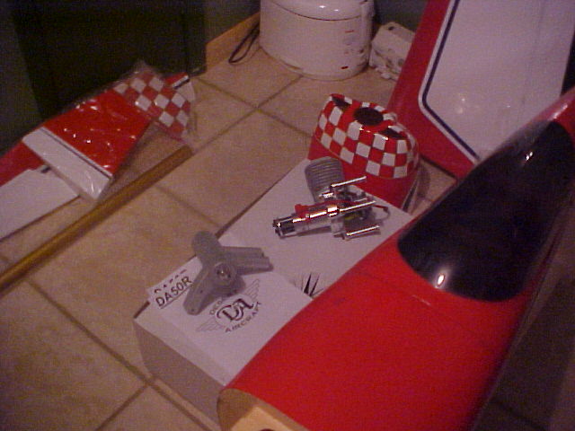

Ok guys I just got my GP Patty Wagstaff, A DA50, and a smoke muffler all new in the box for $800.00. Now I need to decide on the servos, batteries, smoke pump and smoke & fuel tanks.
This is my first gasser!! BTW. The motor has standoffs already, should I mount it solid or should I isolate it somehow? This is not my first 1/4 scale bird so I should be in good shape once I get it in the air.
I was planning on going to a 33% but this deal fell into my lap and I had the cash on hand so......was it a good deal?

Nice plane, good deal. I fly mine with a Brison 3.2 hard mounted with aluminum stand offs. I believe your muffler warranty is void if you isolate\rubber mount the engine. She is a very tough plane, don't ask me how I know
Have fun!

Ya you got a deal I'd say. Mount the motor solid and you'll be fine. For servos I'd go with metal gears for sure like hitec 5945's unless your a jr or futaba guy. I havn't done a smoke system yet so I can't comment on that. For batteries there are so many choices, If it where me I'd put a 1100 4.8 nicad on ign and smoke. For your rx pack something like a 1800 or 2200 6 volt nicad will work fine. Just keep everything simple and you'll be good to go. Hopes this get you started.
