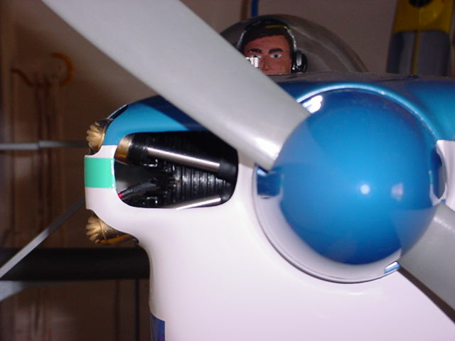

Mine has a Saito 150 turning a 17x6 APC. Overall weight is just shy of 13 pounds. Unless you are determined to make a helicopter out of the model, this combo has plenty of power.
It jumps off the ground in less than 50 feet, and will hold a vertical line almost out of sight before running out of grunt.
And, as you can see, plastic spinners work fine; despite what you might have read elsewhere. This one is a Goldberg. I do not use a starter, however; that would probably be a different story. I bounce-start it with a chicken stick; prime it good and sloppy, and it fires first or second flip- every time.

how is that plastic spinner attached Steve? I dont see any holes in the front of it for screws or anything. I like the look of the matching color, very nice.

The color match was pure luck, bbflyer. After putting down the phone in sticker shock (Tru-Turn had quoted me $58 for a spinner/adapter combo for the Saito 150/APC prop), I remembered that I still had a 3" Goldberg blue spinner that I had purchased over ten years ago for my CG Ultimate, which ended up wearing a three blade prop.
These spinners are basically starter-proof, in terms of popping off or breaking under starter torque (which has been a problem with DuBro spinners used on big engines), since the spinner front has four massive pins which lock into the backplate. No kidding, you need a rubber hammer to pound the thing into place, and a screwdriver to pry it apart. Big-time PITA, but once it's installed, that puppy ain't going anywhere without concerted effort on your part.
