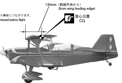

Hi, i just finished putting this arf together, and im a little baffled. I used an OS46AX as recommended by Kyosho (they recommend 46FX, but the AX is virtually identical in weight), put everything where they recommend it, and my plane is nose heavy. by something like 12 ounces. 12 ounces of Tail weight???? What is going on here? There is really no place to relocate the receiver and battery, so I guess Im stuck with lead. any idea why it would come out so off?

Double check your method used to balance the plane. Biplanes can be a bit tricky to balance and the wording in the instructions often times is a bit difficult to follow. Adding 12 oz to the tail of a 40-size bipe doesn't sound right at all.

I used a Great Planes cg machine. I was a little off though, I didnt read the lead right. It was 6 ounces. 2 sticks=6 ounces. Thought it was 6 ounces a stick. I balanced it at 120mm based on reviews of the plane that 130mm was too tail heavy. The balance point is 120mm from the leading edge of the top wing, on the underside of the top wing. Heres a graphic of the CG from the manual.
If I balanced it at 130mm I would need even more weight. The thrust washer is exactly 120mm from firewall, so its not that the engine is way out there. Is 6 ounces too much or is that in the realm of acceptable???

Even 6 oz on the tail seems excessive, but I would double and triple check the balance then fly it. Let me know how it flies...I have a Saito 82a that may soon be looking for a home.

Yeah, I balanced it 4 times on the CG machine, then marked the cg with a metric ruler, and fingered it a couple more. It seems to be balanced just right with the 6oz in the tail. Im going to take it out to the field tomorrow AM and let the club expert have a look at it. If he says go, Ill go with it. If not, Ill work something out.

Canopy...I put the same plane together last month,....Tower Hobbies engine, (bought as a combo package, saved a few bucks)...used a GP CG machine, it showed me as being way nose heavy too, wasn't smart enough, (as you are) to ask a few questions before I balanced to Kyosho instructions....added 3 1/2 ounces to achieve recomended CG....heres what happened...I hope you get this before you go try to fly that thing.

so, that being said, it seemed that yours was tail heavy even when it was picked up with the fingers at the end of the vid. hopefully the 10mm forward on the CG will be ok. This is what worked for a reviewer with MAN. He crashed the first one just like you with the 130mm CG

Well. she flew! Balanced at 120mm she didnt fly very well... Lucky that I wasnt flying it or it would have been lost.. The pilot was excellent. Flew like a duck. Took of 2 ounces of weight and tried again. That just about did it. I think Ill pull 1 more ounce off. Balance point now, flyable is about 102mm. That is 28mm farther forward than Kyosho recommends. What the heck? Are they crazy or what? Where in the world did they come up with 130??? Must have been smokin crack when they wrote the manual. Well anyway, she looks real pretty up in the air. Ill get out this week and take her up myself.

About the balance...I bet they transposed numbers and is supposed to be 103mm!? Anyway, once you get it dialed in give us a flight report, if you don't mind. I'm still considering this bird for my first bipe. Thanks!

"The recommended CG of the airplane is 130mm back from the leading edge of the top wing and I found mine balanced at about 115mm. Moving the battery back in the fuselage got it to around 120mm, which proved to be just fine for the test flights. With little elevator trim needed it seems to fly pretty level at this CG and is plenty responsive."

I moved the battery to the back, and got it balanced at about 105mm with no lead. Took it up today and put a few leisurely flights on it. I think Im going to put a rubber tail wheel on it. Wore the foam one down really bad just taxiing around. I think I may move the CG back a touch. It was just a little mushy. But definitely a good place to start. Perfect landings. It really landed very very easily. It can get away from you on takeoff though. Dont start chasing it. Shut it down and start over. Youre already way behind the curve!

With different "good cg location" results coming from different people with the same airplane, is it possible that it is a result of not taking into account the sweep of the top wing coupled with the particular cg machine being utilized?
I am using a great planes cg tool, and I noticed that, due to the width of the 2 measuring arms, that the measuring pins set back 10mm from the center point leading edge (farthest point forward) of the top wing. This means I have to add 10mm to whatever I set the rulers at the cg tool in order to get the measured cg point. According to the Kyosho diagram, it shows 130mm from the farthest point forward on the top wing.
It looks like I'll need about 3 ounces of tail weight to hit 125mm (I have a Saito 82 sitting up front). I certainly want to hit the right spot as the 1st flight will probably be next weekend. From the discussions so far, I think I will set it at 115mm from the center of the leading edge.

Successful 1st flight last evening! I'm going to have to tone down the rudder & elevator a bit though, as this is a squirrelly little plane with a monster rudder. I had the elevator throw programmed at 80% and it was still a bit much. The Saito 82 is as much engine as you could possibly want on this thing (12x7 prop). I really never surpassed 50% throttle on the whole flight, even during takeoff. It lands really nice at slow speed. From touch down to stop was only 25 feet. I set the cg at 115mm back from the forward point on the top wing.
