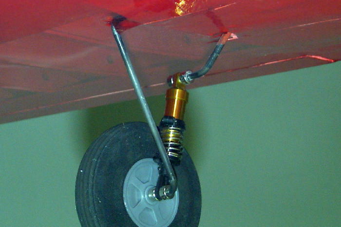

How about this?

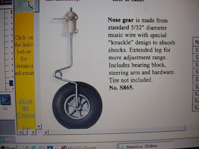

Originally posted by canman
Dave
Sullivan also sells a real nice looking shock absorber type nose wheel/ http://www.sullivanproducts.com/Land...rMainFrame.htm

Originally posted by Jim Finn
How about this?
Jim,
Where can I pick up 3 sets of shock absorbers?.
I guess I can use shocks from the bigger RC cars?

Default landing gear shock absorber
The shock absorbers in the photo are the smallest I could find at the hobby shop in the R/C car department. I have used these on 6 to 91/2 pound aircraft.
In the May issue of Model Airplane News in the "Tips and Tricks" section is a good view of my shock absorbing system.
Hi Jim,
I figured that was what you used.
I seen them on RC cars but questioned how hard of a landing they could take and not damage the plane.
