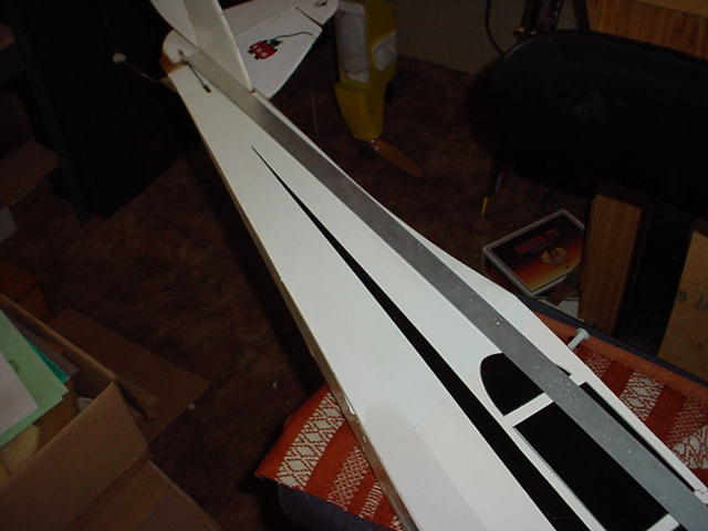

Default Noses over ?
Being a Cub Flyer myself...I'm thinking you need negative incidence, not positive. See Pic of Gold berg Cub....notice the negative incidence ?
It measures 3/8 ". Yes, three eights of an inch.
MUCHO !!! I've been flyin' this Anniversary Cub for about 14 years. That straight edge is aligned with the horiz. stab.
If you have down thrust in the engine...take it out...it is not needed, and is compounding the problem.
Is the plane super nose heavy ?
And tip stalling... There's something seriously wrong here. Is there a warp, or any wash-out at the tips ?

Old 08-05-2002 | 08:03 PM
Flyboy Dave's Avatar
My Feedback: (21)
Posts: 13,864
Received 10 Likes on 10 Posts
From: Pinon Hills, CA
Default Just to show better alighnment.
( and to show I wasn't cheating )

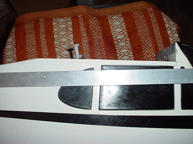

Old 08-05-2002 | 08:12 PM
My Feedback: (21)
Posts: 13,864
Default A little tri-angle diagram.
The wing has a 9" chord.....
3/8" difference..(incidence)...
Using an angle finder...

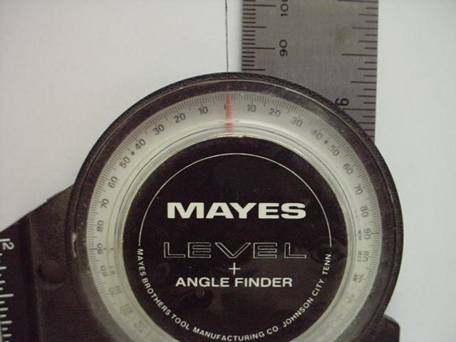

Old 08-05-2002 | 08:18 PM
My Feedback: (21)
Posts: 13,864
Default Lookin closer we see...
That the needle isn't perfectly centered....
and we see about 5 deg. of angle....
So let's call it 4 deg., shall we ?
Just some food for thought...76.ta
Just for the heck of it, I checked the trim setting on the transmitted from yesterdays flight...and the elev., and it appears to have 2 clicks of up trim...
