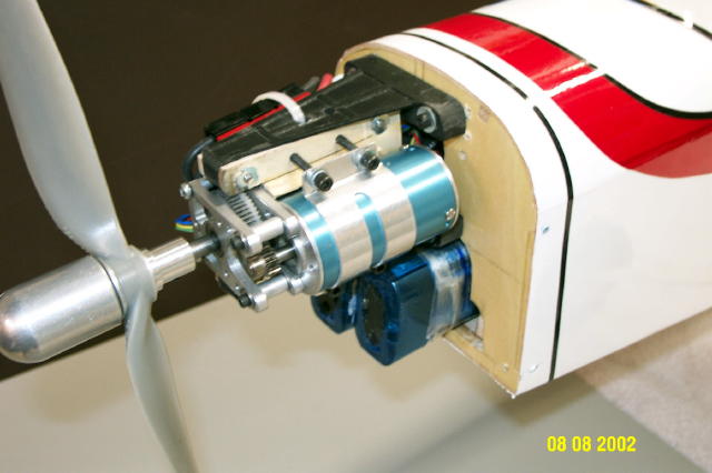

This is my latest E conversion project. This is the new Sig Kadet Senior ARF. It is a very nice model and is typical Sig quality and engineering.
I flew this plane for the first flight today and it was great. It is powered by a MaxCim brushless system using 20 cells and a 3.3/1 gearbox. This seems to be another great combination.
I will give more details and provide more pictures in the next couple of days as I have time. Right now I want to have some more fun flying it. I will be flying it at the Electric Fun Fly in Brockport, NY this weekend.

Here is a picture of the motor mounting detail for the MaxCim brushless electric motor. The supplied mount was utilized and works well. A plywood plate and clamshell mount was also utilized in the installation.

Default Prop size?
What prop has given you the all around best results with your current setup?

Default Prop Size?
I haven't done too much experimenting yet. I have been using a 14x10 which works well. I may try a 15x10 with a 4:1 gear ratio just to see which is better. I don't expect to improve the performance but possibly the flight time.
