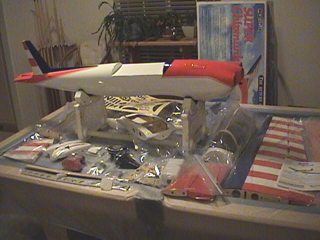

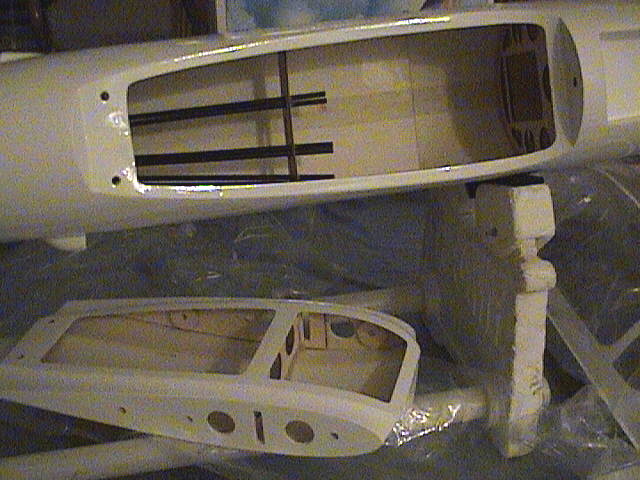

Here's what came in the box! Will have to cut side of cowl for YS Head. This is some beautiful work!

Capt G - it looks lovely. So much better than my WM one!!! You are to blame if I have to order one!

At first look there might be room on the CG above the servos (the wing carry-through box is hollow) for one of those flat jet style tanks. Actually, a Du-bro 16oz std tank fits in that area just fine.

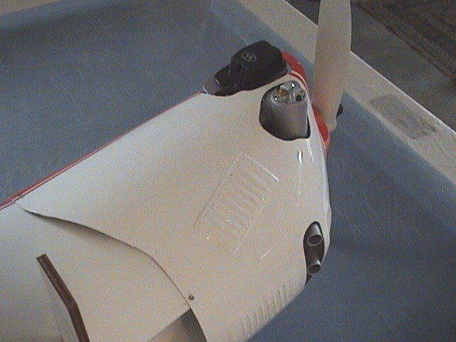

Default RE: New 81" GP Super Chipmunk
One of my least favorite things to do is mount cowls - I guess I just don't like the thought of all that cutting - you guys know. Anyhow, I thought I would make that the first step in building this kit. Of course that means I have to first mount the engine and muffler!. Following right along in the instruction book makes it a breeze. Good quality Great Planes hardware and mount is supplied so that's what I'll use. Four hours later here's what we have. (Prop is APC 15x12) . Weight so far is 6 LBs.

What engine is that your using? It's a shame the cowling had to get all chopped up.

Looks like a YS 120 with a Slimline pitts smoke muffler. My Enya will fit under the cowl inverted with a prop driver extension and I think the G-26 will also fit with a longer prop driver but the muffler will be tight.

Engine is a YS 1.40. Prop is painted with Ultrapaint. I looked at the inverted option but most of the bottom front would have to be cut away. This doesn't look bad . I think any engine capable of giving decent performance is going to need the cowl cut. Even the OS 1.20 they used had to be cut.
