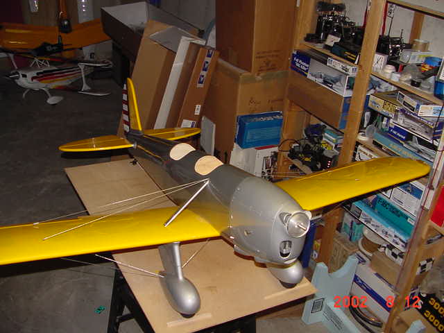

I just installed the OS 1.20 in mine tonight. Everyone says it's MORE than enough. Fits very nicely in the cowl too. I have athread in this forum showing my engine/muffler installation if you're interested. Not too many others seem to care judging by the response I've gotten

From what the various reviews I have read on the Ryan (MAN, MA, RCM, et. al.) reported they all used the 91 4-stroke. From those flight reports they all say it flies 'scale like'. So what does that mean? It means it flies nicely but it is not going to burn up the sky. It will fly on the wing though and NOT the prop. And this is the way it should be. However, that being said, most guys are used to overpowering their planes and depend on that extra power to help them out of a bad situation. Putting a 90 4 stroker in the Ryan will require that you actually fly and plan your manuevers rather than just twizzle the sticks around.
Now you might ask; "Jeff, you're an accomplished pilot that can fly most anything why did YOU put an OS 1.20 on yours? " There are several reasons.
1. it is nice to have that EXTRA power just in case. The fact that I have a 1.20 doesn't mean I'll be blasting around at full throttle all the time. Far from it. It's more than enough to fly it at half stick. I do know how to manage the throttle. But knowing I have a reserve there when I need it brings extra peace of mind.
2. Nose weight. I was suspicious the Ryan was going to need some nose weight and after installing the engine last night and cheching the CG I was right. My saying is 'useful weight is better than dead weight'. The useful weight in my case is the extra power of the 1.20 The tail on the Ryan is sturdy which translates to 'heavy'. Even though the servos are mounted forward by the wing there is still a lot of mass back there. I even have a 5 cell 1500mAh sub-C pack up front.
2. Price. I was able to get a pumped OS 1.20 for $320. That's a bargain in my book. It was only $100 more than a non-pumped OS 91 4-stroke. So I figured for an extra $100 why not.
In my opinion if you use a 90 it will fly. But you'll be flying the wing. Which is 'scale-like'. If that way of flying is comfortable with you then I say go for it.
hth

I also elected to place an OS 120 FS on my STA-M. I have yet to fly it but I am sure after reading these comments I will enjoy it.
As far as the engine goes one other thing needs taken into consideration and that is the fuel tank location, I understand everyone has to use a pump so as not to flood the carb due to tank placement.
As far as the 120 muffler configuration here is a nice tip that will save those extra $$ on that flex pipe. Here is what I did. I took the original 45 degree header and placed it in a vise. I then cut the threaded area just behind the pipe its self with a hack saw. I then placed the 90 degree header on the engine and used the piece that I cut as a nipple to join the muffler to the header, which came out perfect, also saving some weight up front. The locking nut was left centered on the custom made nipple so as to tighten muffler to header. I used the high temp RTV gold instead of lock tight as it has a higher locking bond.
I have a question for you 120 FS users. What size fuel tank are you using? and if it be the 16 oz, how much flight time are you getting out of it? Mine is ready for its maiden flight and should maiden this coming weekend.

Nice tip on the muffler. I've gotten suggestions in another post of mine that a flex pipe is needed because of vibration. That this vibration will lead to fatigue since there's no stress relief like a flex pipe will give. I don't buy into that personally since every flex pipe I've ever had has cracked.
Let us know how the ST-M flies with your configuration. Mine is still a few weeks away. I have to add flying wires and detail out the cockpits, add the pilots, etc. still. I have the stock 14oz tank in mine. From other posts I've made it seems that 14oz will give me plenty of flying time so you 16oz tank should be OK.

OK I just went and took a look at your configuration looks nice. The nipple configuration I came up with allows me the right amount of distance to place the muffler spout right out through the very bottom opening already present in the cawl, No cawl cutting what so ever with no rubbing on any part of the cawl/plane. Since this configuration is quite shorter then what you used, I believe it will help on the vibration issue. I just wish I had saw your post and responded to it before you cut the cawl.
If I get the chance I will take some pictures but I think you have a good idea of what I have.

One more thing I noticed in these pictures that you have not yet cut the other holes in the cawl. The two holes on the very bottom facing opposite of each other I drilled out also to help with air circulation, not sure if you were planing to drill those out.

I did cut those other holes out. The pictures in the post are from before the final mounting. You can see other pics on my ST-M web page on my website. I'm not too upset about the muffler exiting where it does right now. I'm happy I can get it all inside the cowl to begin with
My worries will all disappear when I find that it runs cool enough and there's no overheating. That will make me a happy camper.

I have a Saito 100 on my 90 size edge and if I am not mistaking it gets much hotter then the OS so I don't think we will have to worry to much about heat. At least I hope not.
Heres an example. One of the instructors has a custom built cap which is running the OS 1.20 FS I am running the Saito 100 as I mentioned above. His engine has no problem with the typical rubber extension you find in your LH attached to the end of his muffler. However that same type of rubber extension mounted to the end of my Saito 100 would not last 20 min in the air before it melted off. I have tried everything to keep it on even drilling a screw with RTV gold, no luck. The Saito is exiting inside the cawl which leaves a mess but nothing I can do. Weight is an issue so I can place anymore weight up front.
Although his engine is mounted sideways, his cawl was a scratch built wooden cawl that allows air to flow over the head.
I guess the only way to really find out is to give it a try.
