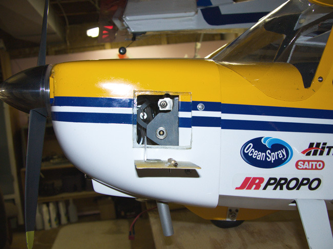

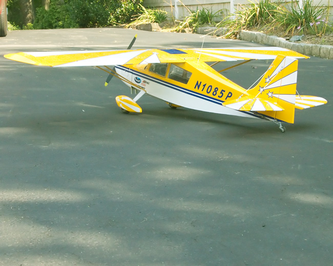

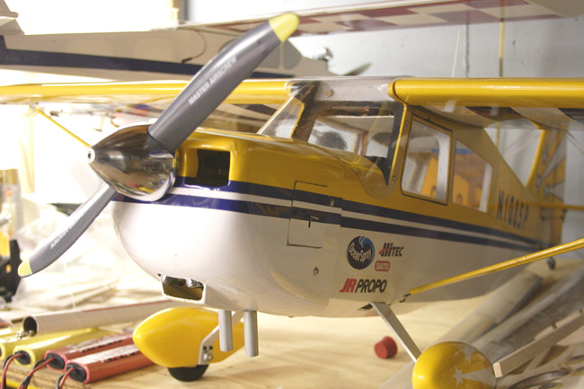

Here's some pic's of mine...Saito 100, HiTec 425's...I put the fueler, and needle valve and glow ext. behind a hatch...It flies great also!

ANE002 your looks very nice, I like your hatch idea. I am considering one this winter with a Saito 100. my only concern was I dont want to cut the cowl and try to maintain the lines. Does your 100 have enough airflow over the head to keep it cool? Any issues with that?

ANE002, is that hatch stock, or did you fab. it? Very nice! Are those Z-bends on the struts? Do the struts come off with the wing panels? I can't figure out how you would attach z-bends while sliding the wing on its tube. [sm=confused.gif]

A-Nuts...(That just doesn't sound right!! [sm=lol.gif] )...The hatch I fabed my self...Crashmaster (Paul Reece) got me started with his Lancair hatch, which I did on my Lancair also...Check for threads by him or on the Lancair ARF on how to do it.....Yes, they are Z-bends, however the other ends that mount to the wings are clevis ends...so you can put the struts on after the wing is mounted....
D-kid...(That's better than A-nuts [sm=wink.gif] )I have not had an issue with airflow..I've flown in the heat of summer without any problem....

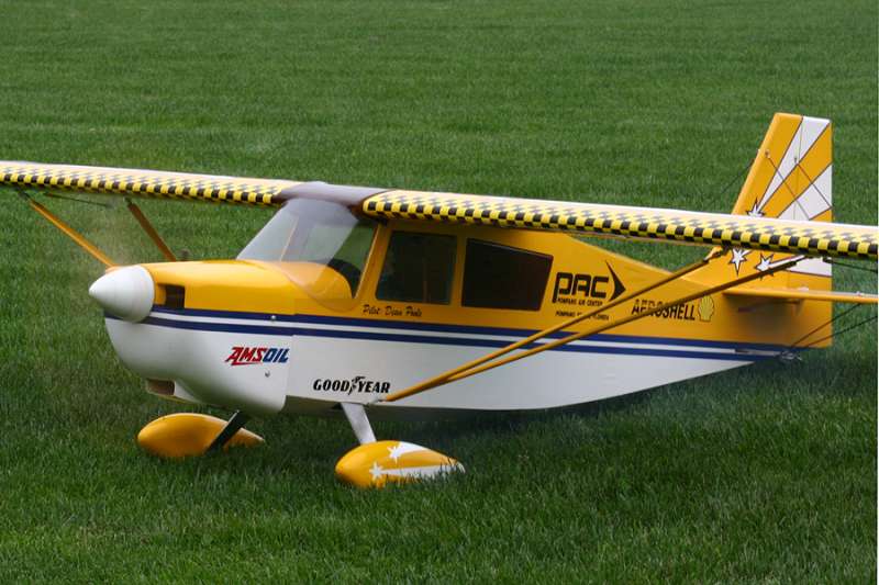

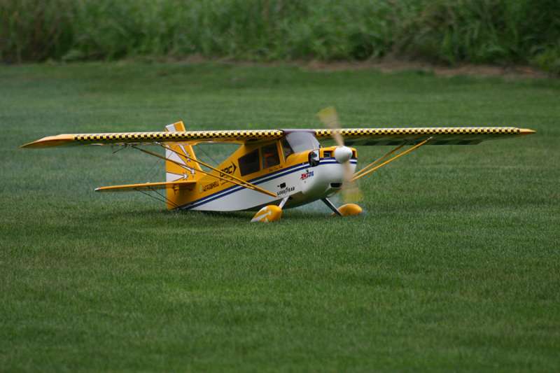

Here's mine. TT .91FS. Over powered it is NOT. Standard JR servos except for rudder, which was higher torque. Found my own decals, added a pilot and checkerboarding to the leading edge of wings. Other than that, pretty much out of the box. It will make a good flyer out of you, simply because it is not so nimble. Rudder is a must. It looks great doing touch and go's. Very scale-like flyer. Buy one and have fun.
