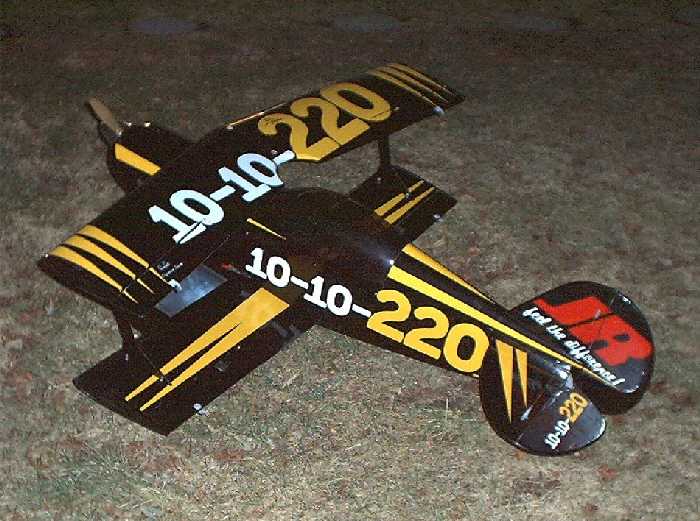

Does anyone know of any ? Yes, I lost mine just recently. It was a pleasure to fly, and tracked like it was on rails, and now it's gone.
The batteries after crash had 75% capacity remaining, range checked excellent. I have subjected every servo, the battery pack, receiver, switch harness, and connectors to vibration using an engraving tool as a source, and I can't make the system fail. It's solid, in fact I'm now flying the Rx in my Shoestring, no problems.
But it seems to me that a while back I remember reading about upper wing or cabane strut failures. Has anyone experienced anything like this ? I'd sure like to nail the failure mode down.
RIP old friend >

Wow, what a beautiful bipe. I'd like to hear about problems as well, because this plane is on a very short "next" list. Sad, it had to go in on you.

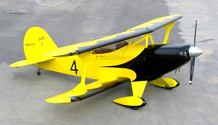

Hi Dick T, thanks for your contribution. No, I didn't call Cermark, don't want a replacement, don't want my money back, just want to go on to something better, and never look back.
Like my great big beautiful Gee Bee "Z" that you are cutting graphics for.

Who knows...maybe I'll sell it if the price is right. It's absolutely gorgeous…done like Sean Tucker’s Pitts. It was even autographed by Sean Tucker himself at an airshow. Decisions, decisions.
-Tom
I have strengthened the center cabanes by adding carbon fiber gussets at the front and rear of each mount and will probably go back and pin them. According to the problems encountered by the guy at this page, I should probably cut away the center sheeting in the area of the wing bolts and lay CF in there. I don't think that it would be much of a chore...matter of fact it may have already been done. The plane came with every other upgrade/fix that I have heard of (except the center cabane fix that I performed).
-Tom
