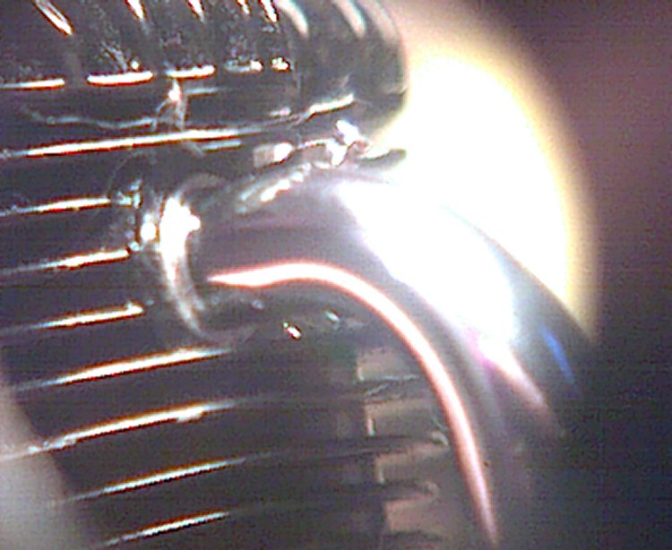

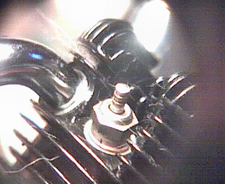

I think your engine just slipped past the inspectors. Every FA-72 I've seen has the metal washer to support the o-ring.

Thanks for the photo, I'll try to find a washer that size, mine did'nt have one. quint, overall they're good engines, this model with the plastic back plate was just a bad selection of materials for the application. I'll have to do a little more research before I buy other 4 strokes in the future.
