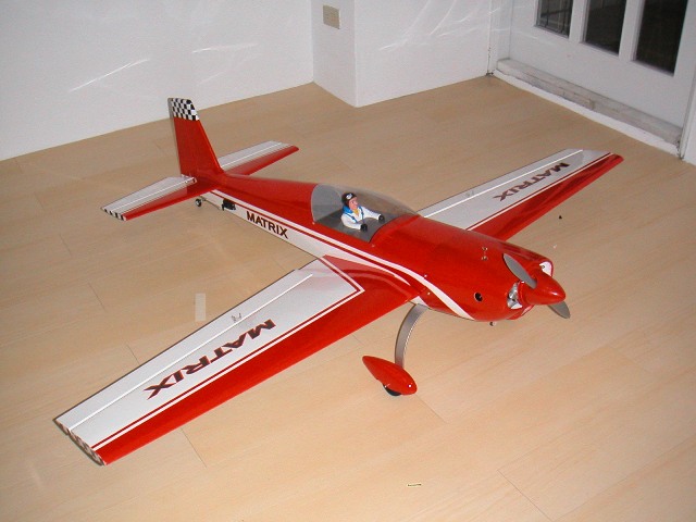

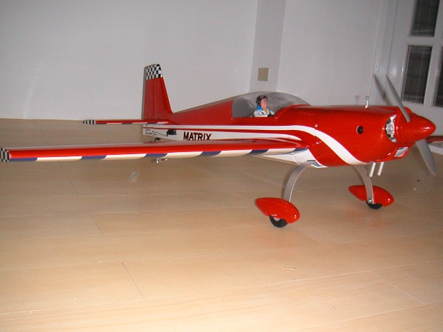

This thread was mine to be hijacked anyway :-) Anyway, I have finished (except still trying to free up a RX) my Matrix... Here she is! She is way tail heavy. I figured she would be with those 2 elevator servos mounted on the tail. Anyway, I will have to put a large battery pack next to the tank to balance her maybe at 115cm, which is 5mm out of the recommended range... what do you guys think?
She is running a
Tower Hobbies .75 with Bisson pitts muffler
Futaba 3001 (x5) with JR mini servo for throttle
Hitech Eclipse QPCM
Polkshobby RX (now in another plane)
Sanyo 6V pack
I am excited to get back to Nitro after almost 6 months on electric!

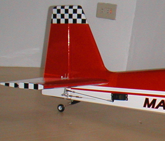

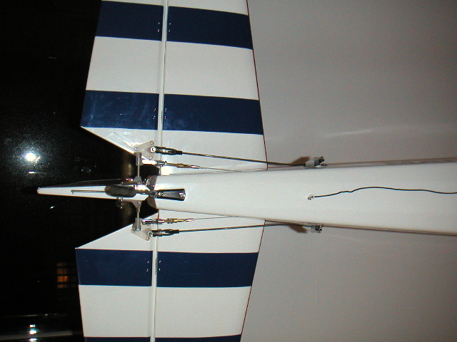

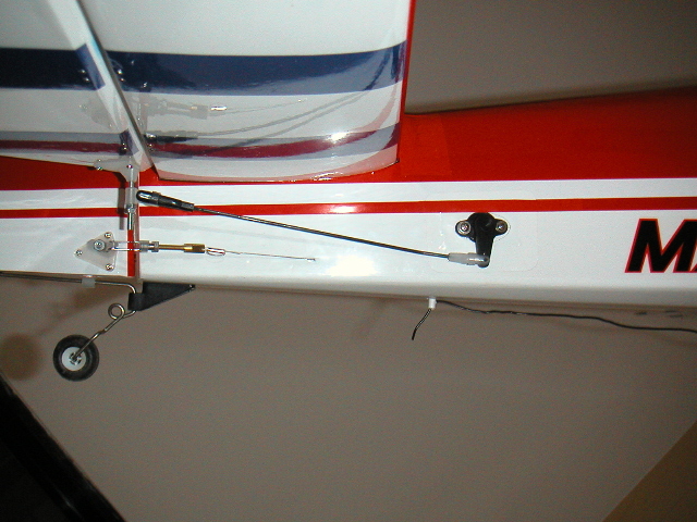

The Matrix is on the verge of revival. Last night I took out the two servos in the back and put in it's place a bell crank I got from an old Veko F3A (I forgot to list that in my crashed planes) supported by two 2mm plywood inserts CA'd into the original servo slots. I'm not sure it will work since the originaly bellcrank width was too short and I had to CA a carbon fiber rod to extend it. Also, I'm new to using CA for structural parts so I'm hoping it will stay together.
Anyway, this has transformed the weight of the plane. As many people have referred to in many posts, servos in the tail have enormous "moment" that needs to be countered by a very heavy nose. By replacing the two servos, I no longer have to put 2 5 cell (c-type) batteries next to the firewall to balance it. In fact, the battery now can be located at the CG. I've also been able to move the tank closer to the CG. I can also use a smaller battery back as well, to reduce the weight. Imagine that, all from moving those two servos.
Now to change to prop to 12 x 7, install the push rods from the bellcrank to the elevator (original ones are now too short) and fly!!! (next weekend unfortunately)
#46
Joined: Oct 2003
Posts: 1,942
From: Taipei, TAIWAN
Okay... here are the pictures of the mod that has transformed the plane!!!
First is the old way that made the plane very very tail heavy.
Second and third are the new way, which, after balancing it yesterday allowed me to do the following:
1. Reduce one elevator servo (important because my Eclipse radio is not equipped to handle two)
2. Eliminate one battery back originally used as dead weight
3. Move the fuel tank one inch toward CG
4. Remove the spinner nut I had beneath the plastic spinner!
5. Reposition the battery pack and Rx just ahead of the CG and not next to the firewall where both are inaccessible.
Now... if it doesn't fly better, I will not be happy!
