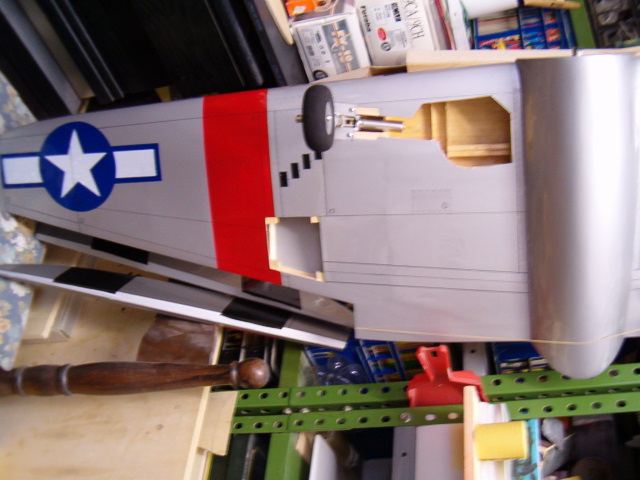

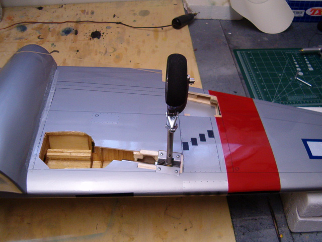

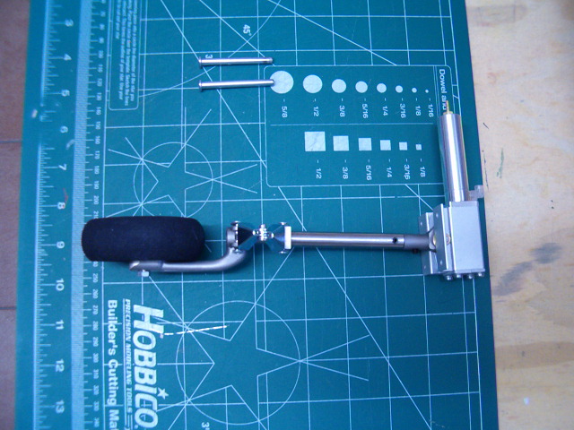

Hi to all,
I started to build and add some detail to my
modeltech P47. I ordered CJ main retract and robart tail. but my question is about CJ's one.
After reworked the wheel bay and fitted the first leg, found a problem: the legs cannot fit inside the wing. the "problem" is that the legs are too scale, and the offset of the wheel cause the problem. see the phots to understand better.
Anyone can suggest me a way to fix this problem?

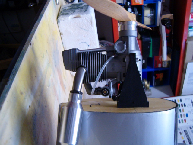

some other photos:

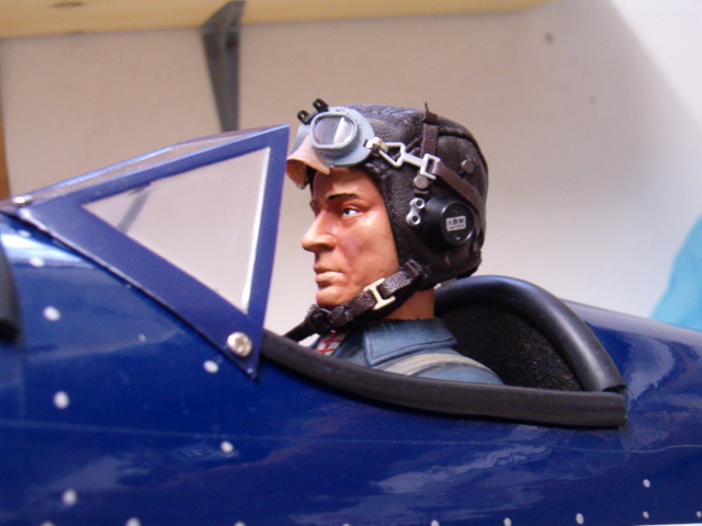

the last one is the pilot putted on my kiosho sterman. I've made a copuùy of BBI spitfire pilot head, and airbrushed.
I want follow the same method to put a serios pilot on my p47

Default RE: modeltech p47 + retracts
Alessandro, I had the same problem using Robart struts. The curved part of the strut hung low outside the wing. Unfortunately, I think the only recourse is to turn the struts upside down and mount them the "incorrect" way.
