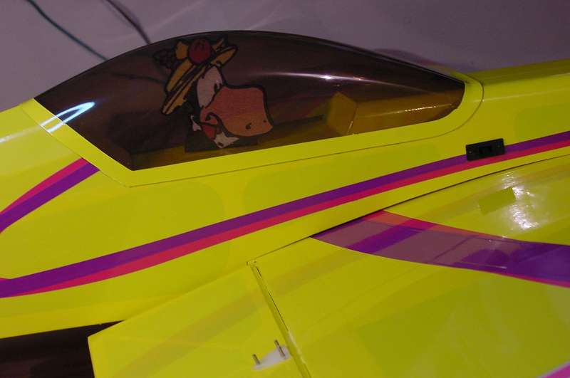

I had a TT .54 FS in mine and changed to an OS 70 because I could not get it to go. I hope you have better results with your Saito 56! I also found that it needed a lot of nose weight in otder to obtain good balance.
