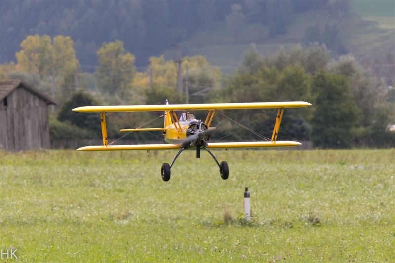

Hi all,
Well after 9 flights I the my AW Stearman is a keeper. What a plane, Like most of you I am using a Siato 325 FA 5R except it one of the single plug that the origonal owner sent back to Saito for the front plug to be added.
Reading the origonal post here about the hard landing gear I made my own using Robo struts for the 77" Zroli Stearman. Boy am I glad I did. Now several menbers of the club I belong to want to buy it and no way am I going to sell unless they meet my very high price. lol.
Bob(N2RYD)

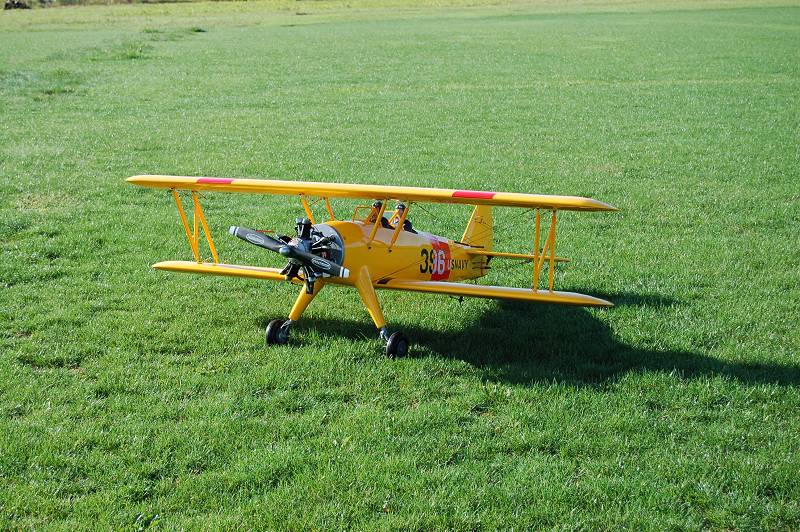

For those buying a used Stearman and are pondering the ASP FS400AR:
[link=http://www.rcmovie.de/video/e51f02c995466f0738ca/Staufenbiel-Stearman-mit-FS400AR-Sternmotor]Aeroworks Stearman with FS400AR[/link]
Flies like a charm!
CG @ 150mm top wing, AOA corrected by shimming the trailing head of the top wing by 4mm
Rev

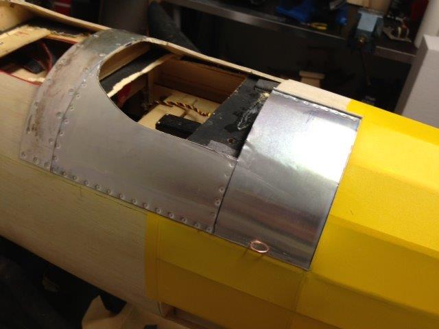

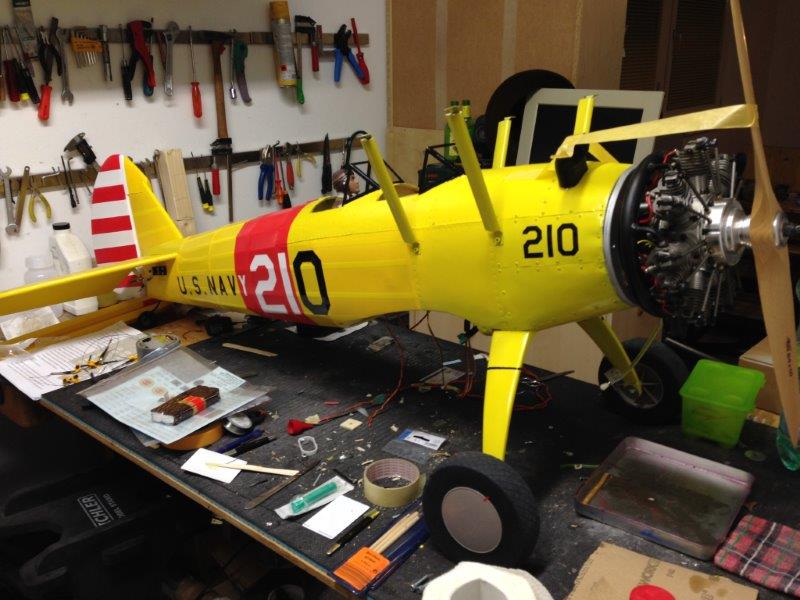

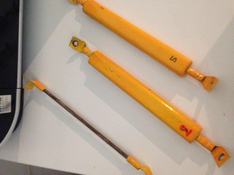

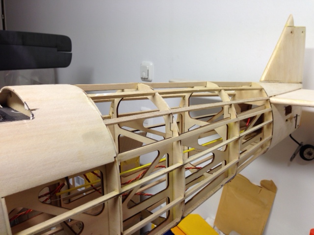

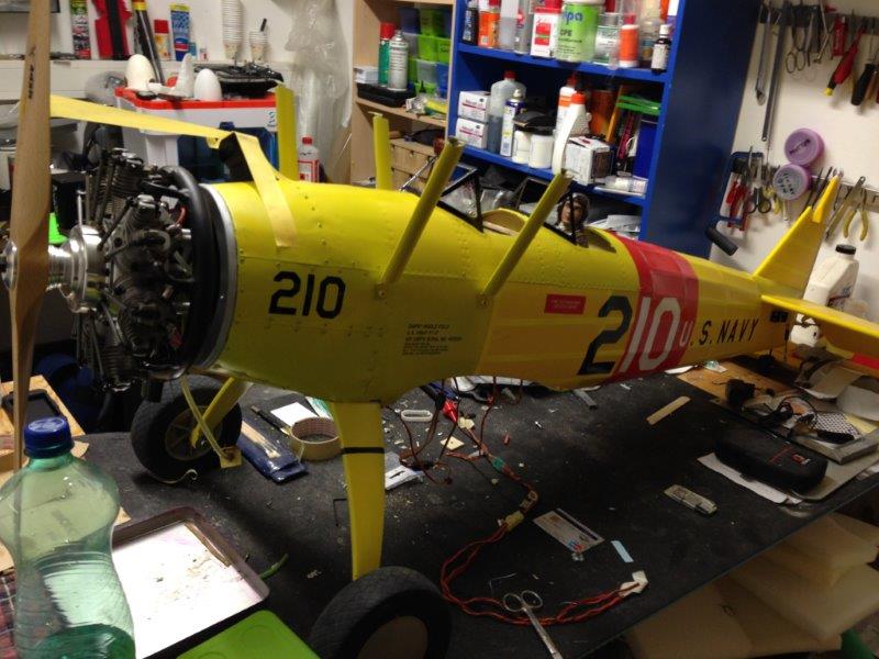

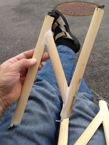

Old 06-06-2014 | 01:05 AM
  #216
Reverend's Avatar
Joined: Aug 2003
Posts: 616
Received 13 Likes on 10 Posts
From: near Innsbruck, AUSTRIA

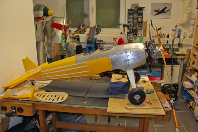

So anyone still flying their Stearman out there?
After two seasons of great service the Stringers in the fuse had started to become loose. I noticed this by the plane getting all fidgety in the air. After stripping it down I noticed nearly all the Glue spots had come loose. It was mearly being held together by the covering! The glue is very brittle so just a heads up to those still flying.
That was a good opportunity to swap all the stringers against fresh ones altogether and while covering I recieved a new load of Litho
So I tried something... And one thing led to the other
The struts are reworked too. I didnt like those square ones very much.
After about 50h of work I am almost done. Cant wait to fly this great plane again.
Rev
