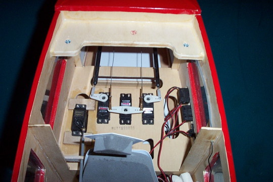

Here is the radio layout. Rudder is a 605, elevators have 300's, throttle is a 3003. Heavy duty servo arms all around. Plenty of room.

WOW a little bit of lead up front!! Nice looking plane.
good luck with her

Yea on blind nuts i am using Hyde mount with the ys and 8 /32 blind nuts i never use the ones they provide nice pictures thanks

that plane looks like it should have enuf room to use a nylock nut and bolt with a good washer. ya can scrap the anchor nuts then altogether. imo -tinman-

what are you using for push rods??

The pushrods are the Dave Brown fiberglass ones. I am using a Dubro 4-40 threaded end extension and Sullivan clevises. I've seen too many planes go in due to balsa pushrods breaking.

are those rods lighter than the balsa??
i was thinking of getting some carbonfiber arrows and using the shaft from them

They are heavier, but to me they are worth it. I weighed a 3/8 inch balsa dowel and the DB fiberglass pushrod material (about .3 inches). The fiberglass rod is about 35% heavier. That 35% increase in weight more than makes up for itself in strength and durability. I have researched arrow shafts and the local archery shops only sell them in large quantities and I don't feel like spending that much money at once for pushrods. Maybe there are other shops that sell them seperately. I just don't have the time. The LHS stocks them and I live 3 miles away. They are around $6 for a pair of 36 inch pushrods and the end fittings.
