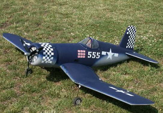

Now for a serious reply. Mine had an OS 120 and balanced a little tail heavy but it flew fine like that. I have just traded for a saito 150 that is a few ounces heavier and that should bring it in better. Just keep the plane out of direct sun as much as possible. All fiberglass airplanes (especially dark ones) will absorb heat and can disfigure. I keep mine covered with a white sheet on a sunny day until Im ready to fly. I have had no problem with direct sun exposure for up to 30 minutes which is all Im willing to chance.
