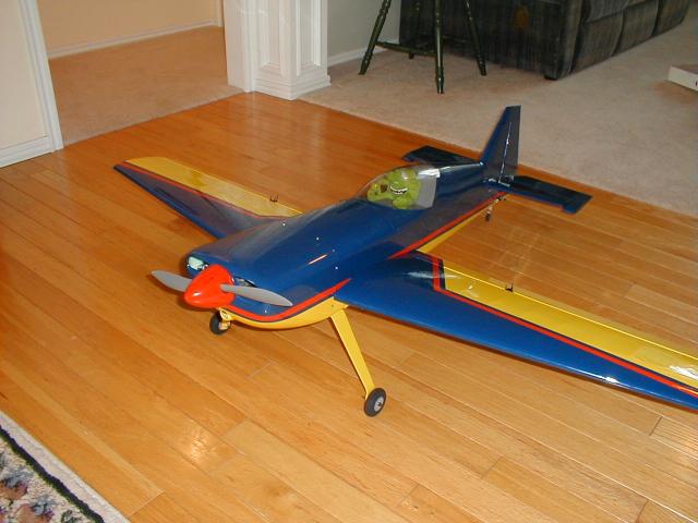

Ok, it was late one night when I installed the pull-pull that came with the Yellow Giles .60 kit. Since I had never installed a pull-pull before I followed the instructions and crossed the cables.
Maiden flight almost ended in disaster. Got a lot glitches but was able to get her down. Come to find out the cables in the kit are NOT coated. I replaced with kevlar (real easy stuff to work with btw) and it cleared right up.
Just wanted to let anyone else know to throw out the pull-pull cables that come with these kits before you're not so lucky.
BTW, before I flew it I ranged checked it and it checked fine. When I got it down I did another range check and once again, it was fine. Then I range checked on the other side of the plane and couldn't get 25 feet. The cables just happen to be between the antenna and myself on that side.

Very strange... I've had 6 Yellow planes (3 in the 60-size) and had no problems with the pull-pull (with interference, tension, durability, etc) through several hundred flights on each plane. It sounds more like a freak incident rather than a regular occurance.
Coated, not coated... shouldn't matter. Inorris - the antenna cable was in the designated tube...? or could there be a problem with a goofy vibration or funky happenstance with the pull-pulls? More details please.. I'm interested!

Tube? There was no tube in the kit nor in the instructions that I saw... Maybe this is the problem.... Metall to Metal rubbing does cause interference so I can't see how you're not getting this if you have it setup the way I did.
The ground check got better when I uncrossed the cables but I didn't want to take any chances. Flew again today without any glitches.

All of the Yellow aerobatic planes have nylon-coated pull-pulls. (This information from Charles at Yellow.) Crossing these lines will not have any residual radio effects. None.
Sorry for the confusion.. the tube I was talking about is the small antenna tube on the base of the fuse... so you can slide the receiver antenna all the way down the fuse with ease...

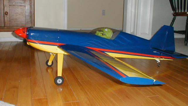

Ok this is odd because my cables I'm pretty sure where not coated nor was there any antenna tube.
It definately was the source of my radio interference as I've now flown several times with no more hits. and I can range check on both sides of the aircraft 100+ feet.
Maybe I got a Friday plane...
In any case, I'm not knocking the plane at all. I like it so far. I used almost all the supplied accessories too which is rare. The tank, cables, and pushrod where the only thing I replaced.

Pants? We don't need no stinking pants....
Actually I fly off of a grass field so while the pants would make it look good, they wouldn't last long.
It did come with some really nice fiberglass pants btw...
