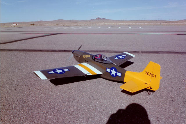

Below is my WM.40 size with a G90 & 12/9apc. Flys great. I am trying to fanagle a deal with a buddy for his WM P-51 Arf (Candyman). He also has a 120fs I am going to try and stuff in it.
