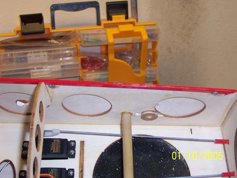

Ok....on the inside of the fuselage....THIN CA nylon nuts to screw into......or, this is a method I use....radio box tape for boats (similar to scotch tape but does not leave a residue), paste pieces over the screw heads when the canopy is in place...it will stop the screw from vibration loose. I have the Seagull Laser 200 with the same method of holding down the canopy....flown 7 times.....and no sign of the screws backing out.
It is a pain to cut radio box tape every time you place the canopy on....If I had the problem, I would CA nylon nuts inside the fuse...the screw holds in tight.

Use 4-40 or 2-56 hex screws with blind nuts. Just enlarge your existing screw holes and insert the blind nuts from inside the fuselage. Throw a little epoxy on each nut (being careful not to get any in the screw hole) to hold them in the fuselage. It is easier and faster to use a ballend hex driver than a screw driver. I use this method to mount the bellypan on my Vectorflight Edge 540. Very simple and highly effective.
Here a couple of pics on how I did it on my VF Edge 540. Hope this helps and good luck.
