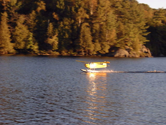

Ok...I'll bite.... I have one on floats with a Fuji 32cc.... takes off on water "no prob"... check pics.
ID:	223194   Click image for larger version
