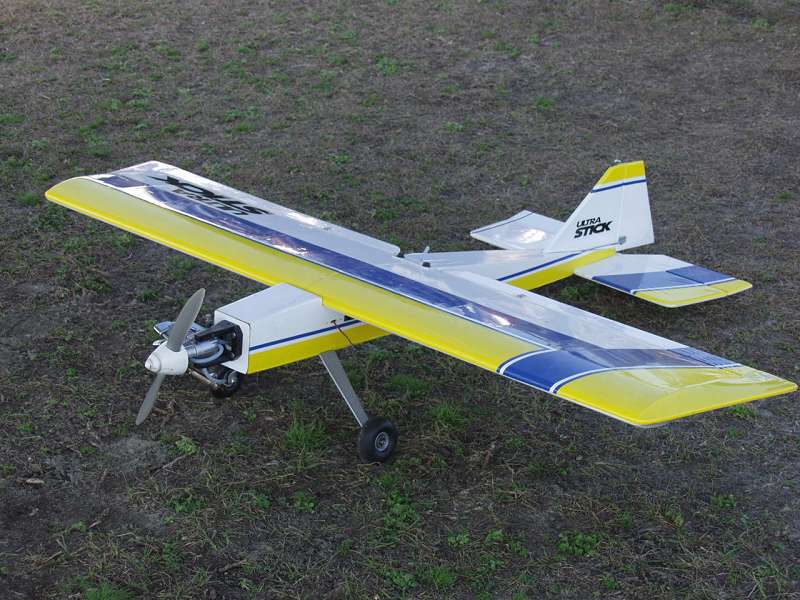

Need some info on a new engine mount for my Hanger 9 ultra stick 40. The one that came with the arf is pretty heavy. What nylon or lighter engine mount will fit the bold pattern on the fuse. Thanks

I plugged the existing holes, epoxy'd the firewall and put a Great Planes plastic mount on mine. I have a Saito 56 on it. There's a Dubro tank in it. It balanced perfect with the receiver and battery in the normal place. I've flown it for almost a year now.
Enjoy,
Jim
