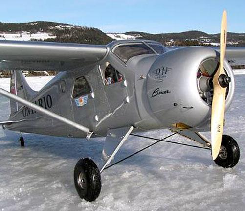

Yes, we are flying the KMP Beaver. (or rather RCFLIGHT Beaver here in Scandinavia, YT International in the UK etc.). In short, it flies very well - much like a big Piper Cub. This means it needs plenty of rudder use in the turns and that it has a low sinkrate, so you have to start your approach early! Otherwise no problems. We fly it on wheels sofar, with a 160 boxer twin 4-stroke and an APC 17x6 propeller. Lots of power for more than scale flying - civilized aerobatics like big loops and rolls are no problem.
Things we will improve on the Beaver:
The roof hatch is cumbersome with 8 tiny screws. It can easily be hinged in the front and fit with a snaplock aft for fast and easy acces to the fuselage inside. The wings can be secured by small steel pins into the main spar like one uses on large, scale sailplanes. We will also replace the standard wheel undercarriage with something more scale-like in aluminium, probably with spring action. But the standard u/c functions very well. The bottom line is: Like every model (and we've flown most of them..) from this producer the Beaver is warmly recommended for it's excellent flying and first-class finish!

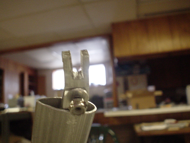

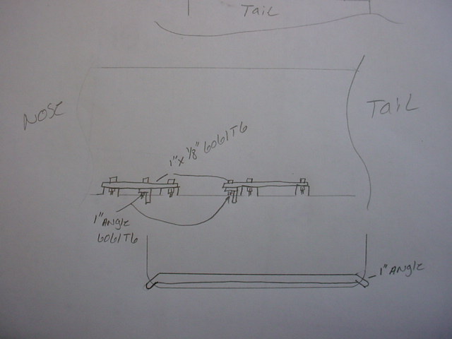

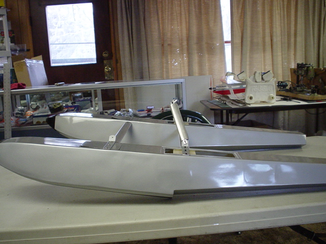

I will make a quick drawing to give you an idea of what I did and try to post it on here. I am still working on the front upper float attach point, but it will bolt to the filer wall and come back to the fuselage penetration. You can find pics of all the beavers you want at dhc-2.com to show the scale locations for the fuse penetrations ( just below the rear edge of pilots door and front edge of rear passenger door).
The float struts are from sea commander and I had to modify the attach points on the floats too. The fittings are in the works for the float struts with the first being roughly completed. I will have the wife take a pic of those later today and post them.

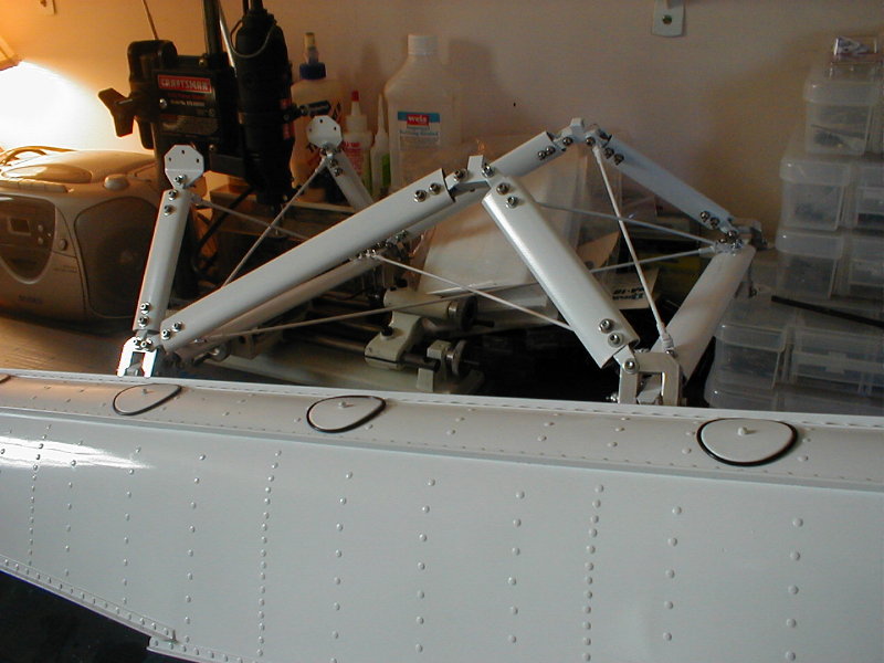

Here are a few shots of the brackets, and the fuse. This is still a work in progress but you get the idea. I will have them completed by the 23rd when I get back home. You can see the slots that the "ears" stick through. Wing Strut mount will attach to the rear float attach point so it will be scale. I only put the supplied strut mounts on to get a flight in before I had to leave for two weeks. Sea Commander also provided structural streamlined tubing for the wing struts. She should look good when done.

float rigging...

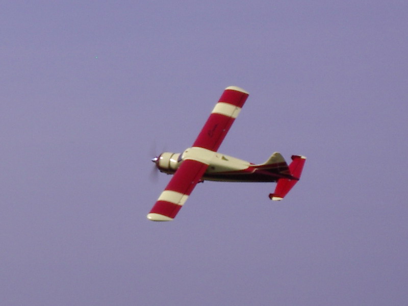

Here is the Beaver mine will be painted like. I have flown this one...

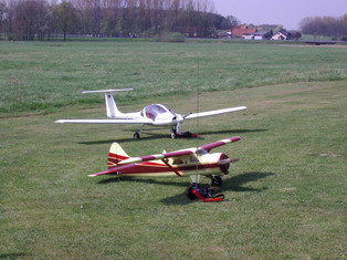

These KMP Beavers are a pretty good aircraft... They take a bit of set-up to get to fly real nice, but once done they are a pleasure to fly.
If you program aileron differential, you will not need alot of rudder when turning, and the plane tracks much better in the turn.
I also moved the CG 15mm forward which improved the flying too.
Landing with full flap is a treat, and the plane can be "Greased" in every time.
Unfortunately, after only 10 flights, I had a faulty extension lead between switch and receiver show it's ugly head, and as a result the Beaver died a horrible death. The MVVS 2.15 gas motor also took a huge hit, so a new crankcase is in order...
I am a bit unsure wether to get another Beaver or not at the moment, although I do still have the float kit still in the box!!!!!
