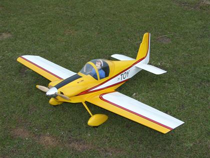

#218
Okay, so am I the only one in this thread who has noticed that the model doesn't seem to have nearly as much dihedral as the full-scale? Or is this just an illusion?
Question for Chris White how much dihedral is in the full-scale Corby? It looks to be at least 5 degrees, if not more, where the model has a quite shallow angle. Can't see the number in the full-scale three-view included in the manual.
The spirited look of all that dihedral is a significant contributor to the cuteness factor of this little plane, IMO. I plan on making a new ply joiner for mine, with more dihedral, if that's what it takes.

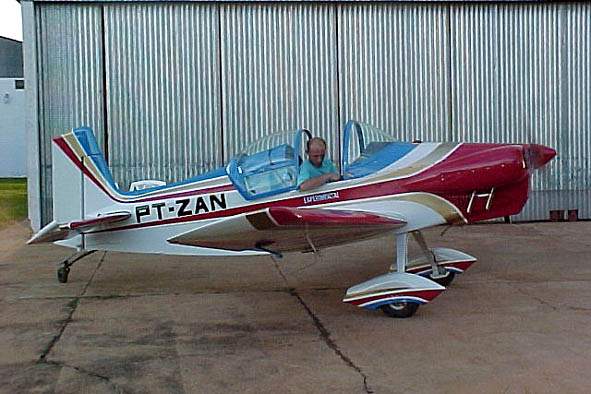

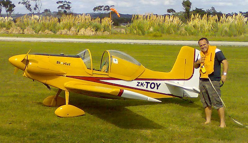

#220
I found these pics of Corbys in similar orientations, one is a full-scale, the other two are models. Tell me you can't see the difference in the amount of dihedral here.

You are 100% correct, the model Corby does not have the same amout of angle in the wing dihederal as the full size. I buit 3 version of the model before it went to the factory, all of them had small changes in one way or another.
With regards to the dihederal the reason it was lowered as the model would show signs of pro - verse roll when rudder was applied in both level flight and in knife edge flight. Simple put pro - verse roll when applied makes the model roll in the same direction of the rudder direction in both knife edge and level flight, the first protype that was made had the scale dihederal and it did pro verse roll quite badly, hence the change to what it is now. Its all a bit of a compromise when you design model's and when they are used by the public it is even more important to get it as close to every bodies skill level. I do agree with you all the same that the dihederal is a nice feature of the full size.
REAGRDS
CHRIS WHITE
REAGRDS
CHRIS WHITE

Just looked at the pictures,the centre Corby is not one of the ARF Corby's from Sportsman Aviation,this can be seen by the colour scheme,cowl and the wing tips, but also agree who ever made this one also decreased the dihederal for some reason.
REGARDS
CHRIS WHITE

Chris,
Yeah, the model in the middle picture is the RBC kit; a little smaller than the Global kit, but same minimal dihedral, from what I can tell.
Sounds like you experimented a bit with the dihedral, and ended up with the setting you did to prevent that sashay that comes from an over-powerful rudder. I've had other models with large rudders and a lot of dihedral, and you only had to breathe on the rudder to get it to roll like a Pitts. It's that pesky yaw-roll couple at it again.
I will still add some dihedral, knowing full well what effect it is bound to have on my model, and report back here. I expect I will also end up with lots of aileron differential throw, to keep the adverse yaw to reasonable levels (another side effect of too much dihedral), and I will need a deft touch on the rudder stick in the turns. I don't plan on doing any knife-edge or precision aerobatics with this one, I'll leave that for the Cap-n-Extra guys. But I expect the snap rolls will be nice and crisp!
What a cutie-pie the little Corby is! Gotta love it!
