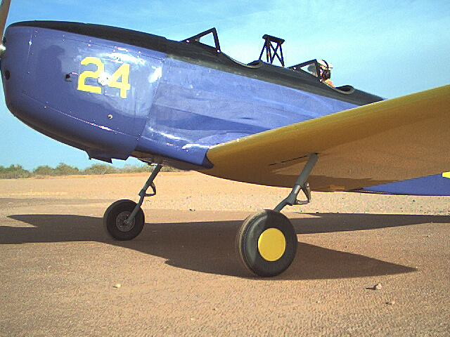

OS .91 Surpass. Flies great and exhaust is completely hidden? With an on board glow the ONLY hole in the cowl, other than the three scale openings up front, is for the needle adjust.
