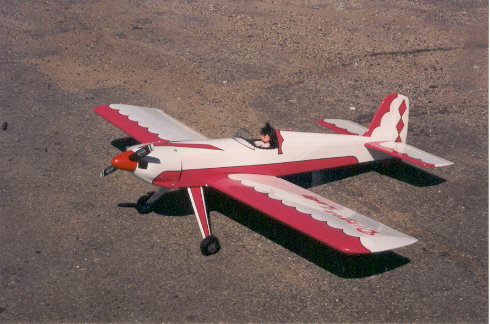

Old 09-22-2002 | 03:15 PM
Posts: 95
From: Milford, CT
Default dragon lady
HI I have been flying a Dragon Lady for 8 yrs .I fly mine with a O.S. 120 and a 15x8 prop.I have never had a problem.Two years ago I had to remove the fuel tank as the clunk came off so I installed a complete new tank(it was after all six yrs old I fly it every week.
