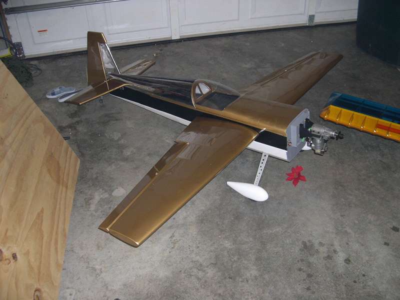

Well I have one and here she is.
I agree with your post as for the craftmanship in the kit (awesome)
I did recover mine for I really did not like the red and white that came on mine.
Would have prefered the yellow and blue scheme.
The one and only issue I had was the landing gear bolt were slightly off and I had to make corrections. NO Biggie
Here is a list of items I used in my plane.
Saito 1.80
JR4721 for the rudder
hsbb77 hitecs in the wings
hitec micro servo on the throttle
hitec 625's on the elevator's
great planes 24oz tank
Also running on board glow from electro dynamics.
Have a just a few more things to accomplish before she is ready. Just some loose ends.
Outside of that have fun I'm sure they will fly great. And you can't beat the 199.00 price tag.

Default RE: power line hobbies edge 540
Hey Cub good tip on the rudder servo I looked back there in the tail and I had clearance but I went ahead and did that mod for the in case factor. REGARD'S
