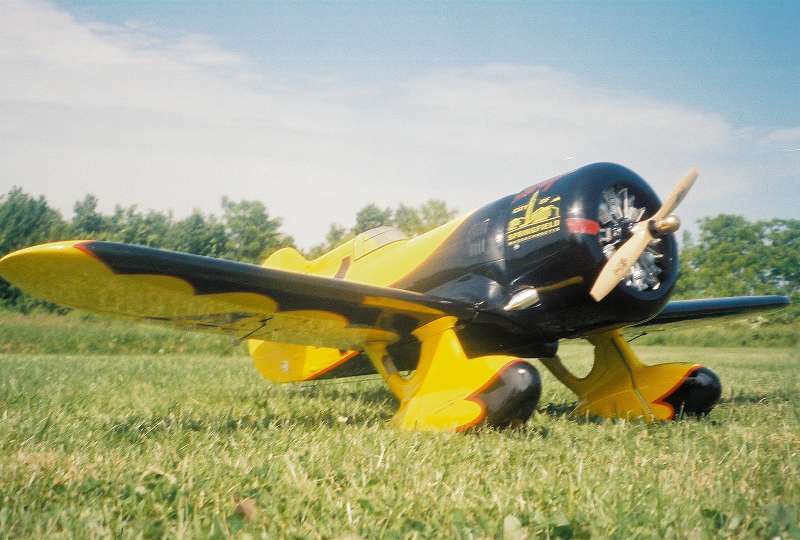

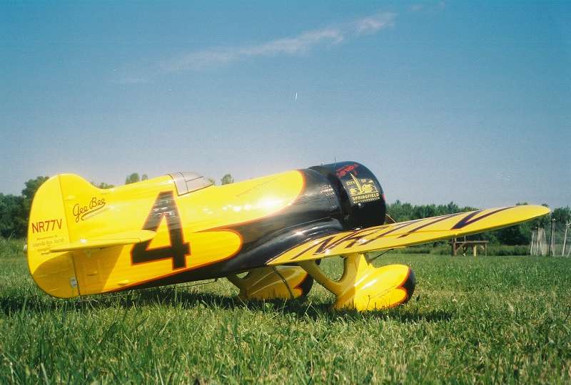

I loved to fly mine. I'm having flash backs to last yr when at the field my landing gear / wheels got caught up in the grass and it did a 360% flip. I check it all over and all seemed well and fueled it back up for my next flight... Unknowne to me the battery had come loose and went to the rear of the plane.. Now it was totally tail heavy. Just like the first post mine took of then went straight up. I knew instantly what was wrong. I leveled it a litte, but continued to climb. I got it way up in the air, but everytime I touched the elevator or alerons to make a move it would snap over and dive. Lucky I had a saito 82a in mine which saved me. After about 4 dives which scared the bejesus out of me I figured to just used rudder only to bring it around and used throttle control to bring it in. After about 4 attempts I finally got it low enough where i forced it down. It slamed down from about 2 feet and broke up the wheel pants pretty bad.
For sure the balance for CG has to be a little forward of the recommended spot. and keep the throws down. It doesn't take near as much as you might think. I love mine and will continue to fly it...
